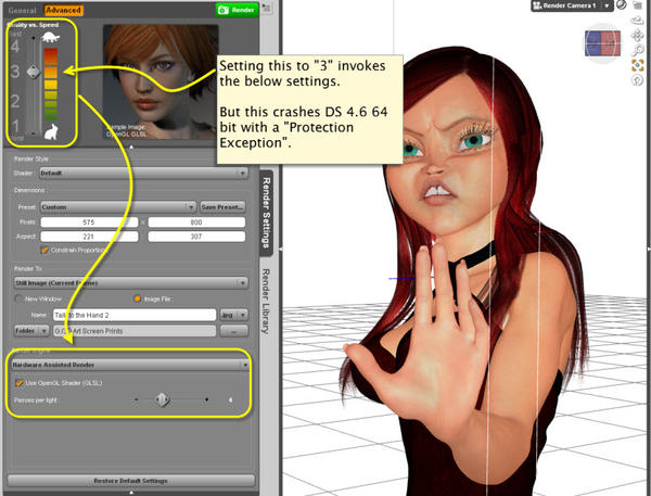

I just did a simple render a few minutes ago, and I was having a hell of a time getting DAZ Studio 64 bit to just stay up!
Finally, I ended up setting "passes per light" to 1 and rendering straight to disk, but I don't know if one or both of these things was indeed the corrective action.
I have an AMD HD 7970 graphic card and have no trouble with it or the drivers.
I saved one of the crash logs, and here are the settings that seem to crash it on my system. As soon as I post this, I'm going to reboot and see if I can reproduce the error.
If the error is consistent and not fixed by a reboot, would it be worthwhile to provide this dump information to DAZ?
800 x 609 - 113K

    Hey folks. AMD did indeed have a new driver out there, so I installed it and rebooted. Same problem though, the hardware render crashes now with this particular project file. But yeah, this GPU is certainly capable of "GPGPU" work, including hardware assist rendering tasks.
    So I'm thinking it's the project file. There's got to be SOMETHING inside it that is disagreeing with my graphic card and/or DS. And I think it may just be the single key light I put in there.
    And yes, at least I know that I can render to disk...although that's not ideal long-term. Anyway, a process of elimination is warranted here.
    Is there anything in the app dump that might help point me in the right direction?
