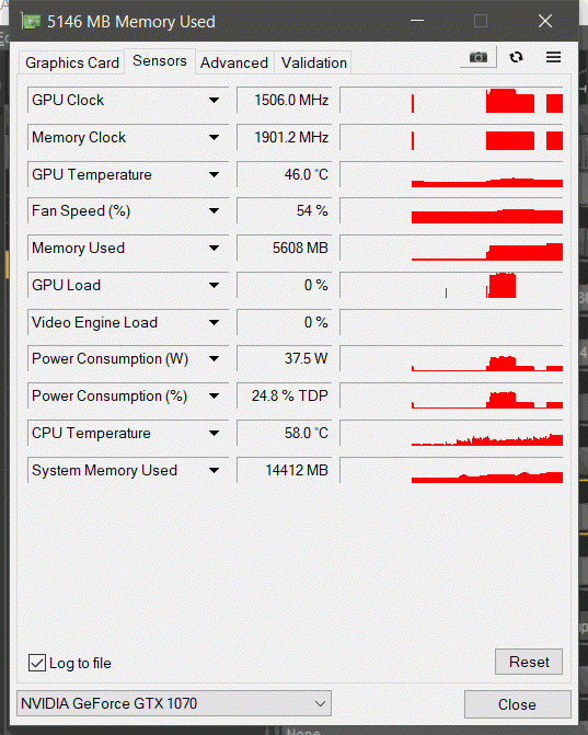

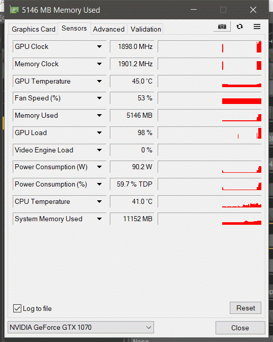

    And here's screen shots of GPU-Z showing VRAM usage during Frame 1 (GPU) and Frames 2 and 3 (after CPU fallback). The figure in the title bar (5146 MB) is the maximum value recorded during that session (though it doesn't seem to reflect the actual figure in frame 2).
    537 x 671 - 20K
    537 x 671 - 21K
    537 x 671 - 20K

    More information on the Image Sequence issue.
    These scene that was failing contained two characters (G8 and G3) and very few props. I had previously run Scene Optimizer to reduce the texture sizes by half.
    1. Tried another image sequence but removed one character. Scene rendered past frame 1 and continued. No fallback to CPU.
    2. Loaded scene again with both characters and then removed the other one. Same result as pervious attempt - sequence rendered (no fallback to CPU).
    3. Reduced textures by half again with characters present in the scene. Result: scene rendered ok past frame 1 again. VRAM peaked at around 5GB in frame 2 according to GPU-Z (I'm starting to mistrust the accuracy of GPU-Z).
    So my question remains: why would IRay render the first frame happily but then suddenly require more VRAM for the second - causing the render to drop to CPU?
    I did notice one further curiosity. I have muscularity morphs on my characters and I noticed that between scene one and two, the little IRay progress window was reporting loading lots of .dsf files (morphs). I am not aware that morphs take up much (if any) VRAM but I thought it worth a mention.

  • RayDAntRayDAnt Posts: 1,167
    marble said:
    RayDAnt said:
    marble said:
    I tried again with 4.12 Beta, 440.12 drivers and rendering an image series. I cut the scene size down to under 5GB and ran it. GPU-Z showed VRAM at around 5.3GB for frame one and then 6.4 for frame 2 but by then it had dropped to CPU (without exceeding the 8GB limit). I then tried it in 4.11 (Optix Prime off) and it rendered the whole image series without a problem. The only problem was that a 4.12 scenes opened in 4.11 was doing odd things so I didn't make any chages -  just rendered.
    I find it hard to believe that I am the only one having this image series problem but then that's not the first time.
    What happens if you attempt to render the image series in 4.11 with OptiX Prime acceleration switched to ON? Because that's the mode you should be using if you wanna make an apples-to-apples comparison between 4.11 and 4.12 rendering behavior.
    I did try that and it did drop to CPU with Optix Prime switched on. However, I suspect that this indeed did force the VRAM above the 8GB limit so forcing the fallback. That was not the case with the 4.12 render - it dropped to CPU well short of the 8GB.
    This proves pretty much conclusively that increased OptiX Prime memory consumption is the underlying cause of your CPU fallback woes in 4.12. And the fact that total memory usage doesn't go all the way up to your 8GB limit in GPU-Z before it happens is actually immaterial. A program like GPU-Z only tracks successful memory allocations within a GPU's physical memory limit - not attempted memory allocations beyond that. Go back to the troublwshooting info you posted earlier and take special note of CPU-Z's reported max GPU memory used (5608MB), the total memory available on a 1070 GPU (8192MB), and the specific language in the error meesage preceding CPU fallback:
    OptiX Prime error (Device rtpModelUpdate BL): Memory allocation failed
    In other words, memory allocation for OptiX Prime acceleration failed due to (8192 - 5608) 2584MB of free space not being considered enough for the task.
