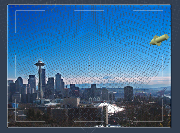

Any way to rotate a backdrop?
TurnerTurner Posts: 116
I'd like to rotate the backdrop (Backround has a rotation slider......) but don't think I can. I'd rather not rotate the whole scene if I don't have to, but think I might have to...
Any help appreciated!
thanks,
Andrew
    There are no rotation controls for the Backdrop because it will show up no matter where the camera is positioned.
    To see the Backdrop while you are setting up your scene, you can open the Interactive Renderer (little circle icon with an up arrow) and enable the Show Backdrop check box.
    A couple caveats: The image you use in the Backdrop has no image based light effect (such as the Background) when the skylight is enabled, it will not reflect, it should be the same aspect ratio as the final render (or it will look distorted) and it will be visible in all the cameras including the director's camera

    You can use an hdri in the scene's Background and an image in the Backdrop to hide the hdri. This way, the hdri provides IBL lighting and reflections, while the backdrop stays the same no matter the angle.
  • TurnerTurner Posts: 116
    Right - but the backdrop doesn't rotate with the HDRI...
    I know that.
    I guess I don't get what you want. If you want a spherical image, then use one in either in the background or map it onto a sphere. If you have a standard image, but need it to look as if the camera is panning or tracking from side to side or up or down, then map the image to a plane and use it like a billboard.
    If you have a panoramic image, then make a curved surface, somewhat like a cyclorama and map the image to that.
    You can use a regular, non-HDRI spherical image in the background and enable the Skylight in the render room and it will act just like an hdri, though a bit less dynamic.

    A couple caveats: and 'Backdrop' will be visible in all the cameras including the director's camera
    Not Strictly True evilproducer,
    If you have 8.5 then we had a couple of nice little features added to cover this, esspecially handy
    if you are working a matchmoving scene.
    In the Interactive Render Settings box there is a new checkbox marked 'Show Backdrop (Directors Camera)',
    unchecking this will stop the backdrop showing in the directors camera. Also, if you select any camera in your
    scene (except the directors one) and look in the properties tray's 'General' tab, in the 'View' section you'll
    find a new checkbox called 'Show Backdrop', unchecking this will stop the backdrop being visible in these cameras
    too. These little additions ensure that if you have a backdrop loaded up you can restrict the backdrop to only be
    visible in your chosen 'Render Camera' thus leaving your 3D Views windows free. Much easier to consentrate on
    what your manipulating in the other views.
    Tee Hee
    Post edited by pscammp_2e78c43842 on

    Turner,
    'Rotating the backdrop' does'nt make much sense to me either but if thats what you want to do then
    who are we to stand in your way.........
    Try This:-
    Drop a flat plane primitive into your scene and position it face on to your intended render camera, open its
    shader and load up you backdrop image/video into the colour channel and turn off all other options like
    reflections, transparency, highlight etc, in properties tray be sure to disable cast AND recieve shadows. Then,
    rotate this plane in front of the camera.
    Obviously this plane will need to be a bit oversized because when your plane twists 90 degree's one way
    it will not fill the field of view for the camera horizontally so a little thaught will have to go in to the planning.
    The higher the resolution of your image/video the better in this situation.
    Just a Thaught......
    Good Luck
    Paul
