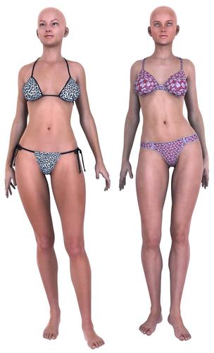

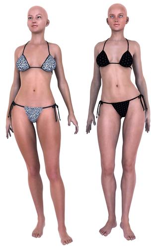

I knew where to find the Victoria 6 HD slider in the Body section and it's on, has been. It defaults at a 100%, so that's not the problem. I thought there were more morphs in a special slot that accentuated the points they promo-ed, like the way your morphs work. I couldn't find them so I guess there isn't any. Victoria HD defaults at full potential. I uploaded two samples one without any morphs added, just Victoria 6's out of the box and on the other I added your knee morphs to both dolls. In the picture without the morphs you can see the knees are pretty bland and pretty identical, considering one is supposed to be hi-def. They're both flat, no shape. With your ZEVO morphs added to the knees, you can clearly see they look more realistic on both dolls. Very nice morphs by the way.;-) But I bought the HD, so I expect to have it show without your morphs.:roll: The HD morphs for the knees are fantastic in the promos but I don't see them here. The lights I used are Age of Armours Advanced ambient lights with AO and one uber spot on raytrace. It's just a quickie render, max a few minutes. The AO would have picked up any shadows in the skin. Are there better lights to use? But see, it shouldn't matter.>:( The morph textures aren't based on UV so I shouldn't need great lights to get the ripples in the skin to show. These are real morphs that when you turn sideways will have texture lumps and valleys, not appear flat like UVs do. So...are you telling me HD Victoria 6 is kind of...anemic?%-P More hype and photoshop enhancement than reality?

Whoops the titles don't show, so the first picture is with Zevo Morphs and the second picture is without the Zevo morphs. The point of adding the Zevo morphs was to show how nice knee caps look with morphs. The V6 HD looks the same as the V6 Non-HD with no Zevos applied. V6 HD is the one in the leopard bikini. Can you tell the difference?

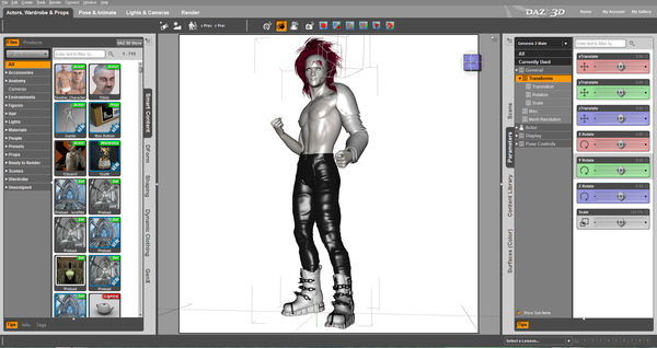

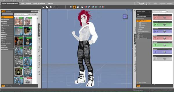

Here's how do do that :)

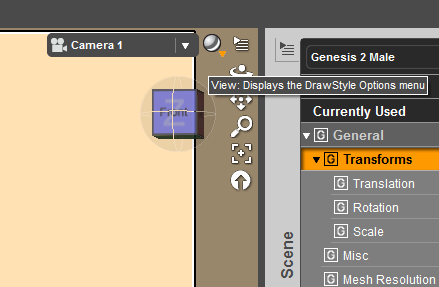

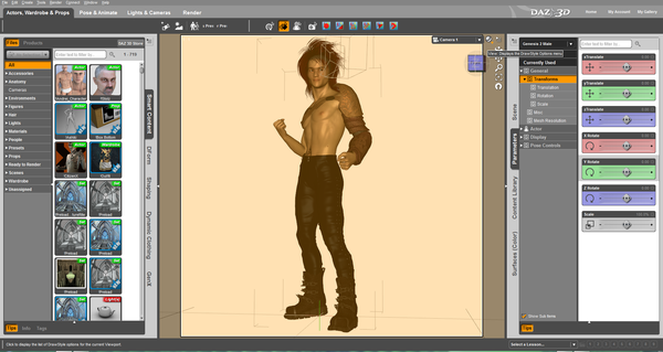

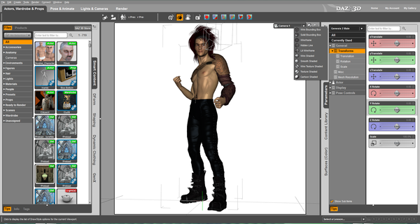

After opening the scene (pic 1), put your cursor over to the top right of the frame and the Draw options menu will appear (pic 2, 2a), Click the ball for the dropdown menu (pic 3, 3a)

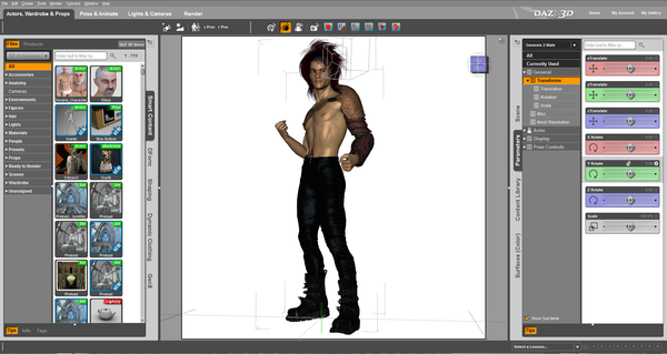

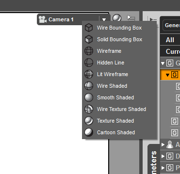

Then choose the option from the dropdown menu. Wireframe (pic 4) or Smooth Shaded (pic 5), which is what you're looking for, I think. Texture Shaded will restore the scene to what it was :)

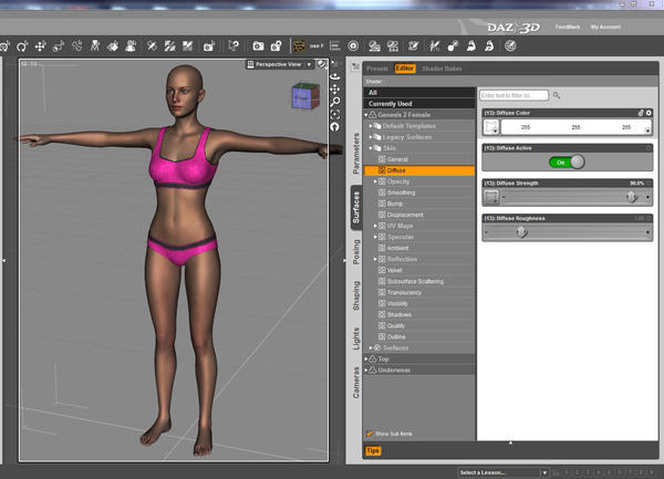

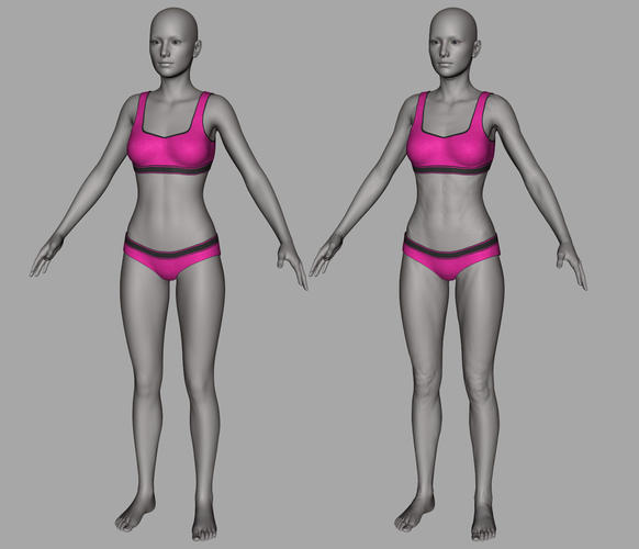

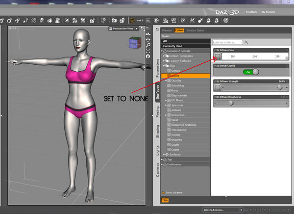

Hi Moon_Baby. To remove textures do the following. Go to the surface tab, choose skin and on the diffuse channel, change from multiply to none. You can do this for bump and displacement if you wish as well. Then do renders with no lights in the scene to see all the mesh detail. Hope this helps and have a merry Christmas:) See attachment pics.
Here is an HD comparison, one with and one without the morph dialled. Alternatively if you wish to see the HD details before you render, simply change the sub-division level under mesh resolution to 3. You will have to set that as the limit since by default 2 is max:)
