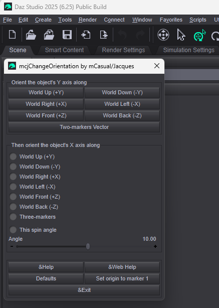

  • TugpsxTugpsx Posts: 803
    edited January 4
    Welcome to 2026. Here is an updated version of ChangeOrientation that works in DazStudio 2025. This is a very useful tool that allows you to change the pivot point of one second selected asset to match the origin of the first selected asset.
    Example make a  cube orbit a sphere .
