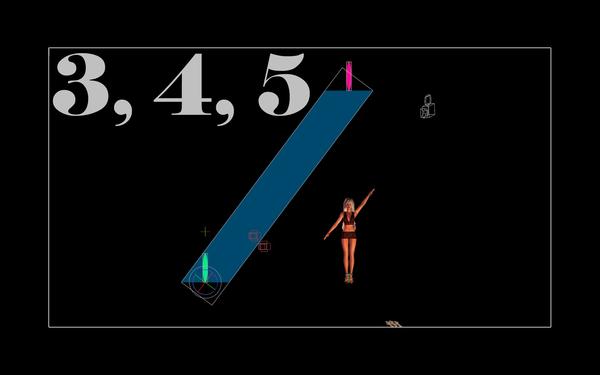

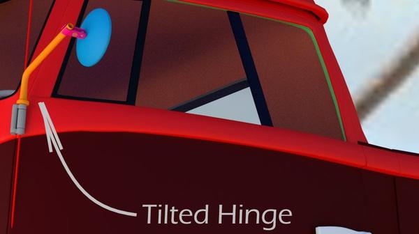

as you could see in the movie "it's tilted, babies" ( https://www.youtube.com/watch?v=GDGXSmuEr0U )
sometimes you need a hinge rotation axis that is not vertical and not horizontal
for car doors notably
it could possibly be useful when building low poly prop-figures ( stickman )
i'll see if i can also make it helpful for steerable car wheels

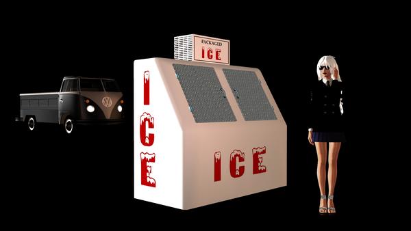

Agent Amy Hanging out near the ice merchandiser
( includes tilted hinges, babies )

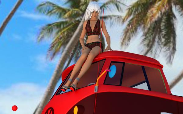

    gotta finish this tilted-hinges script,
    then the plan is to quickly wrap up the Amywagen ( volkswagen pickup )
    then have the physics simulation thing ready for xmas, so people have something to play with at 4 am on Dec 25

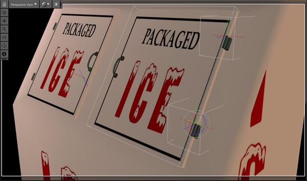

    for the test case the subject ( door ) was moved away from its load-time position and was rotated 45 degrees
    1188 x 699 - 94K

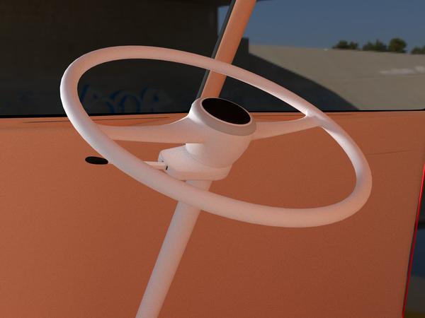

    The User Interface in DS3
    and the steering for upcoming tests
    new improved fidelity steering for the Amywagen
    ( the reference being 1967 bus / pickups
    on some VW items there's the coat of arms of the city of Wolfsburg - a two-tower castle over which paces a golden wolf with a blue tongue.
    1600 x 1200 - 179K
    1600 x 1200 - 349K
    459 x 269 - 26K
    Post edited by mCasual on
  • mCasualmCasual Posts: 4,607
    edited December 2013

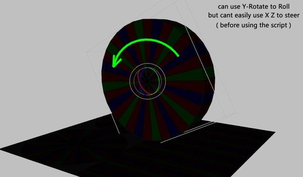

    when you use a primitives/cylinder as a tire
    the x y z axis don't allow you to have the wheel roll and remain steerable
    but using this script you'll be able to reorient the Y A xis
    and get the roll & steer without having to use nulls
    a sad thing is that yesterday was it, i had almost completed the script when Daz Studio crashed on me
    and apparently i never saved this version !

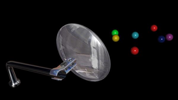

    complex test case for the axis re-orienter script
    the Amywagen mirror
    1920 x 1200 - 286K
    it worked well but only when thee 3 elements of the mirror assembly were in an unrotated state to start with
    so i have to re-discover the code that i used for the Ice Merchandiser door test
    600 x 600 - 631K
    1906 x 795 - 1M

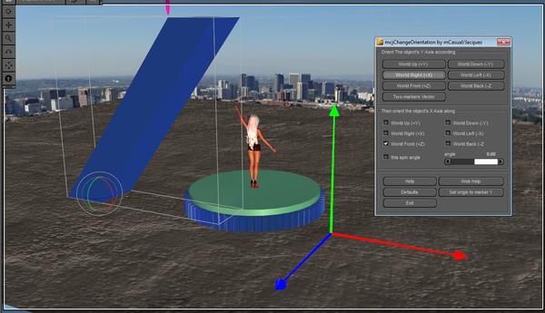

    By the way, have you ever written a script that would reposition a prop's world rotation? You know sometimes when you load a prop and then try to move it around the rotation seems really off, like the prop fly's away from the position it was previously in? I've always hated when that would happen, esp in 3D space, you just don't know sometimes where the hell it went! lol Might be useful!

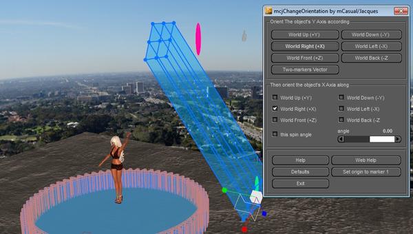

    adding all those options gets a bit confusing
    but it may let you rig a custom prop just the way you want
    in this case the Y Rotation Axis ( green circle ) of the object was re-aligned along the World's X axis ( red arrow )
    and the X Rotation Axis ( red circle ) of the object was re-aligned along the World's Z axis ( blue arrow )
    1300 x 748 - 166K

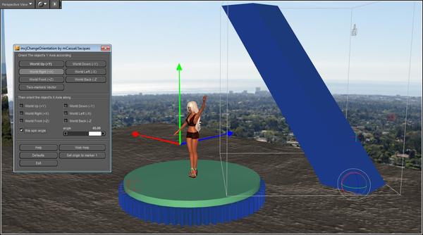

    also shown in the image below, rotating the rotation frame 45 degrees using the "angle" slider
    1413 x 787 - 156K
    the finishing touch, i added the "three markers" mode
    the line going from the first selected marker to the second gives the prop's new Y-Rotation axis
    and the line going from the first selected marker to the third gives the prop's new X-Rotation axis
    ( the script forces the second vector to be perpendicular to the other )
