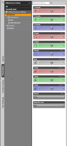

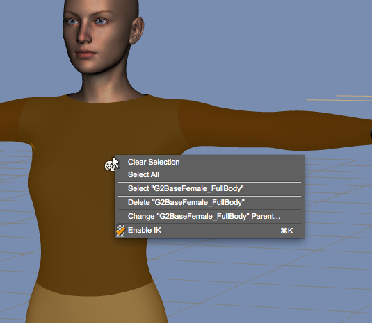

  • jtlyonsdenjtlyonsden Posts: 0
    Thanks for the reply, but none of those options are available. There isn't a "Fit to…" option available, which is why I posted here. I'm wondering if I need to export and then import? It says that it's designed for one of the Genesis females (Gia, Victoria, etc.), so maybe it doesn't work natively with the base figure without going through a few extra steps…? Just guessing here.

    I think I got it. I experimented with the Transfer Utility and that seemed to work. Thanks again!
