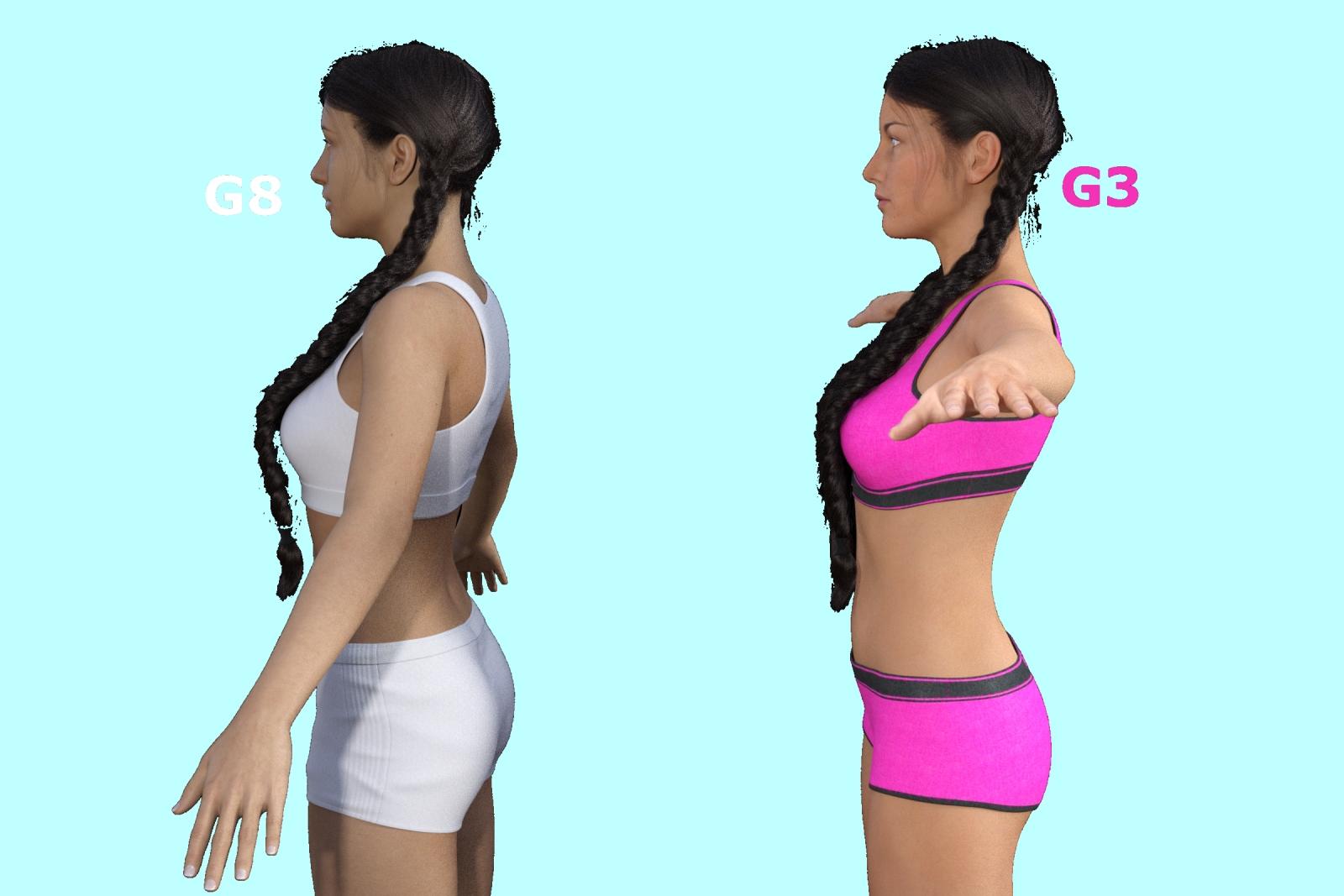

I'm having a problem with the "Marigold Hair for Genesis 3 and Genesis 8 Female(s)" by "outoftouch".  There is a kink at the end of each ponytail that I can't figure out how to correct.  As the hair loads the ponytails are hanging correctly but once it loads completely (and follows the figure it is loaded onto?!?), the kink forms.  Is there a way to force the hair to not follow the figure and use the custom bones for posing?  Once the kink is present it is there always, even if I using the posing dials to move the hair behind the shoulders.  Any help would be greatly appreciated.  I love the hair but this is driving me nuts.

    I do not get that kink in the Marigold hair for either G8 or G3, and I even tried parenting the hair to things like clothes and G8's eyelashes, also applied the 'behind the shoulder' presets for both hairs, without being able to duplicate your problem. This is with the basic G3/8 characters.
    Could you have some misbehaving morph applied to your character?
