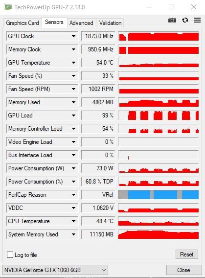

    Just to let you know that this specific issue doesn't seem to happen in my pc. I did a simple test and the vram seems to be handled fine, apart the extra buffer needed for optix in 4.12. From gpu-z the used vram in my card is about 2.7 gb and it doesn't seem to grow up in time. I use the iray preview, so there's about 2gb for the working buffer that's loaded at startup, plus about 0.5 gb for the scene itself. My system specs are in the signature. I included the scene duf file for testing.
    It would be nice if you can include a test file yourself where this issue does happen. Possibly as simple as possible and including only the free standard content so anyone can test it. This way we can compare and test to see if this issue happens to everyone. This may also help the daz developers to better understand when this issue rises up.
    my simple test:
    1) load the g8f
    2) apply the idle dance animation
    3) render
    DAZ Studio 4.12.0.86, nVidia Driver 431.86 studio, Windows 10 Pro 1809
    Ryzen 3 2200G, Geforce GTX 1060 6G, 16G RAM, 480G SSD

  • marblemarble Posts: 7,500

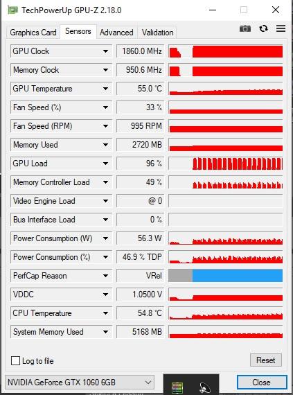

    EDIT. I tried a bigger scene with an environment and some dressed characters and it seems to work fine, I mean no memory leaks growing up in time. To take more resources I didn't resize textures so they are at 4K. Scene file attached.
