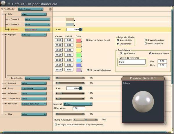

    The pearl white, is that a pearlescent or opalescent color with shifting colored highlights depending on the viewing angle? Or is it a glossy solid white? I ask, because sometimes those subtleties don't show up well in photos. Especially with lighter colored paint.
    The shader I created, that anybody is welcome to pick apart, is my attempt at a pearlescent or opalescent shader. I've set up SSS in the shader, but have it turned off by default. To turn it on, just enable the checkbox.
    The shader is probably a bit more complex than it needs to be, but I hadn't looked at the reference images that were linked to. ;-)
    https://dl.dropboxusercontent.com/u/7370483/Pearl-copy.cbr
    1024 x 768 - 380K

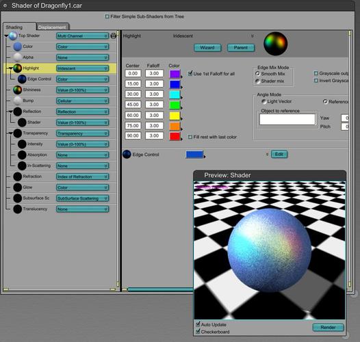

    Here's the Dragonfly Eyelid shader.
    It was done with the Shoestring Shaders plugin.
    798 x 758 - 93K

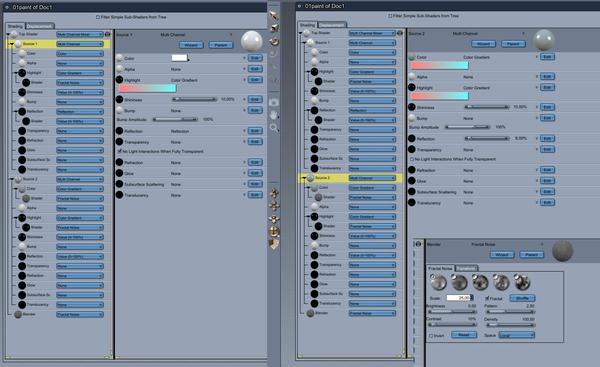

  • VarselVarsel Posts: 574
    Here is a quicky from me.
    Using a multi channel mixer, with a fractal noise as a blender.
    For a more distinct colour variation one can change the contrast value in the fractal noise mixer.
    In this I use the same fractal noise in all the channels that uses fractal noise.
    1200 x 733 - 386K
    800 x 600 - 318K
    Your shader looks a lot like mine, except I also added an extremely muted color gradient in the reflection channel and the translucency channel as well.
    To the point about SSS, I agree that it will help. In fact, the shader I posted on Dropbox above has the SSS channel set up, just not enabled.

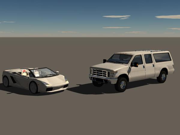

    Here's a quick rendering of the Foberghini and my project both in Evilproducer's Pearl White Shader.
    1024 x 768 - 39K
    Turk_WLF said:
    Thank you for all of the help....
    Looks good!

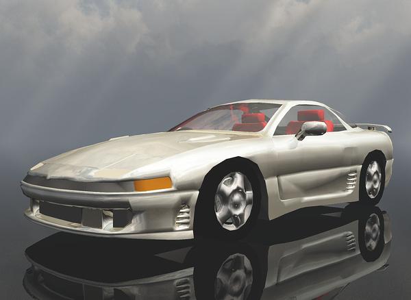

    Here is a WIP of a 1991 Mitsubish 3000 GT VR4 which I owned. I scanned in the color called Glacier White Pearl from the original brochure. I have a jpeg of the color if it will help.
    1069 x 780 - 125K
