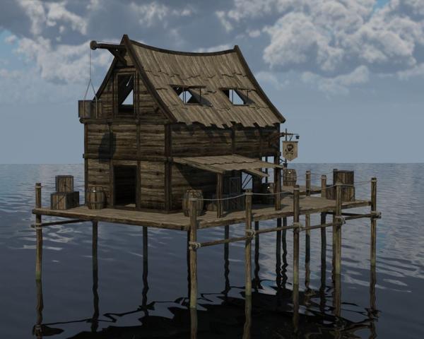

  • dpm316dpm316 Posts: 0
    edited December 2013
    Here's a test render I did last night. I added the Reality Sun and removed the Sky in the LuxRender GUI. I dialed the Sun way down as you said. I left it with just enough brightness to cast shadows. Any brighter and it starts looking fake. I do have a few questions: It seems to work fine with just loading the DT preset directly instead of loading the RealityIBLSphere first and then loading the preset. Is there any use for the RealityIBLSphere? I'm not sure what you mean by "load the preview". Lastly, it defaults to 60% opacity. I changed it to 100% to see it better in the DS window. Does it matter for the render? Thanks.
    Peace \/
    dpm316
    1000 x 800 - 92K
    Post edited by dpm316 on
  • cwichuracwichura Posts: 1,042
    The opacity of the IBL in Studio doesn't matter in the actual render; the RealityIBLSphere geometry is not exported to Lux in any way/shape/form. Only the IBL settings are exported, and IBL settings have no opacity value. That said, having the sphere partially transparent is useful when switching to the Sun object to see through the sphere when matching up the alignment.
    The benefit of the RealityIBLSphere is that it lets you adjust the Y rotation of the IBL and have a visual reference of what the IBL will look like. "Loading the preview" is something the DT preset does when you have the RealityIBLSphere selected when you apply one of the DT IBLs. Again, it's just for visual reference within the DS viewport.
