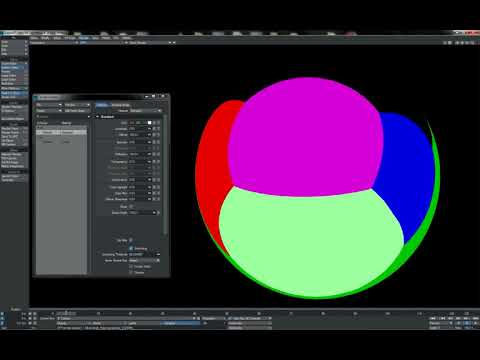

    If you've a LOT of spare time & REALLY want to understand this stuff, you might want to visit here:
    This was done for Ligthwave, but the principles apply to ALL CG apps using Iray, PBR, Cycles, etc.
    Craig, aka RebelHill is a highly respected guru in a number of CG circles.  You can't go wrong bookmarking this info.
