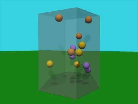

    Hi hrpschrd,
    The Scene Forces evilproducer was refering to are different from the surafce properties in the Effects tab. You can find them by clicking the icon next to the Camera Icon in the Toolbar. They are Directional Force, Point Force, Damping Force, Torque Force and Flow Force. You can also find them using 'Insert'. Screen grabs at the end of this post to help.
    I made a quick animation by creating an enclosed box in the Vertex Modeler, 6 sides. I then created another seperate Vertex Model, a sphere, default Object Definition of 8 and gave it one level of smoothing. Back in the Assembly Room with the sphere selected, under the Motion Tab, I changed the animation method from Keyframe to Physics. I then made several duplicates and and gave them some pretty colors. :)
    For the Box, in the Effects Tab, I changed the Bounce to 100% and dropped Friction to 1%. I left the Spheres at their default values. I then turned the Visibility of the Box off.
    I then inserted a Flow Force, and just used default values. I then clicked the Simulate Physics button, and once finished, made a quick render:

  • DesertDudeDesertDude Posts: 1,239
    edited August 2019
    Hi hrpschrd,
    Sorry, wasn't at my computer yesterday and sorry for any omitted details.
    hrpschrd said:
    - i assume you moved the balls around after duplicating.
    Yes, After duplicating each set of 3 balls I offset them from each other so none of them were touching.
    hrpschrd said:
    Something about the vertex modeling of the box? It was set for eight.
    The box is made of of a cube, 6 flat planes, no extra polygons/subdivision/geometry.
    hrpschrd said:
    It was set for eight. The balls definitely don't move as smoothly as yours.
    The spheres are default drag and drop from inside the Vertex Modeler. All I did was apply smoothing, If you accept the default sphere its Object Definition is 8.
    hrpschrd said:
     I don't have "flow force" in my instances box.
    Hmmm...did you drag a Flow Force into your scene from the drop down like in the screen shot in my first post (it's the last icon in the drop down menu). Or, go to Insert > Flow Force (down near the bottom of the drop down list).
    hrpschrd said:
    One of the balls went well outside the box.
    Ah...okay, maybe as FENgari suggested above you need to adjust the Simulation Accuracy, Geometric Fidelity and Collision Distance settings. You can find those settings by clicking 'Scene' at the top of the Instances Tab, then look for the Physics Tab. I set my Simulation Accuracy to 1000% - the simulation calculation is a little slower, but not painful. I also set my Geometric Fidelity to 100% and Collision Distance to 10%.
    hrpschrd said:
    I obviously don't understand this. Is flow force only applied to the balls?
    Yes, because only the balls have changed to Physics from the Motion Tab. Motion > Physics. (See the screen grab from my previous post.) The box is still set to the default Motion > Keyframe.

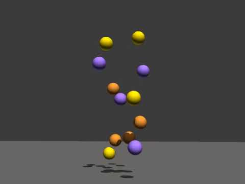

    edited August 2019
    OK, it was  pretty easy, not sure if this is the exact look you want...you probably have to make adjustments to the strength of the forces, but here we go!
    Align the spheres at the top in rows. Make sure there is a little space inbetween each of them.
    Since you can't keyframe Gravity, set your Gravity in X,Y and Z to 0.
    Insert a Directional Force (Insert > Directional Force). It comes in by default pointing down, which is convenient.
    Insert a Flow Force (Insert > Flow Force).
    At frame 0, turn the Strength of the Directional Force to 0. Do the same for the Strength X,Y,Z and Rotation Strength  of the Flow Force - set to 0.
    I moved the playhead of the timeline down to frame 36 and entered 2.00 for the Directional Force. Then at frame 48  reduced the Strength back to 0.
    For the Flow Force, I copied the first frame and moved it to frame 12, essentially holding the values at 0. Then, at frame 36 increased the Strength of X,Y,Z and Rotate Strength to 20,000 each.
    I added a gentle ramp up for the tweeners as the Strength increased for both the Directional and Flow Force.
    Hit the Simulate Physics button, let it do its thing, then rendered.
    Like I said, you will want to adjust the values to suit your own animation.
    edited to add: make sure the initial aligned spheres have a little space inbetween each of them
    hrpschrd,
    I'm sorry for you agony and frustration.  Maybe it's time to post your scene so we can dissect it? I think you have to post it as a ZIP file, if you are willing.
    I'm going out for a bit (it's Friday night here where I am) but will check in later and...offer more diagnostic advice.
    Posting your latest test/scene would really help.
    Cheers

  • de3ande3an Posts: 915
    Here's another method.
    Open a new Medium Scale scene.
    Insert a cube (I just used a cube primitive). Choose a transparent shader with no refraction (I used the Basic Shaders "Transparency", and changed the Refraction channel to None).
    Insert one Sphere of the appropriate size and set it's Motion Property to Physics. Choose its color now if you want them to all be the same.
    Use the Duplicate command to make as many spheres as you need and arrange them all inside the cube but not touching it or each other.
    Insert a Directional Force and set its Strength property to 6.00 ft/s^2. Place it directly beneath the cube. With the force selected, go to the Modifiers tab and add a Spin modifier. Choose the x or y axis.
    Now click the Simulate Physics button in the upper left corner of the toolbar and watch the action.
    edited August 2019
    Hi hrpschrd,
    Did you also set the values for the Physics Engine under Scene > Physics? Did you set the Pysical Properties for the Box and the Spheres under the Effects Tab for each of those objects?
    Under the Physics Engine I have:
    Simulation Accuracy: 1000%
    Geometric Fidelity: 100%
    Collision Distance: 10%
    Gravity: Use Default Gravity 'checked' , X=0.00 Y=0.00 Z=0.00
    Physics Solver: set to 'Bullet'
    For each of my Spheres, under the Effects Tab > Physical Properties I have:
    Collide with other objects 'checked'
    Density: 1.000
    Bounce: 95%
    Friction: 5%
    For the Box, under the Effects Tab > Physical Properties I have:
    Density: 1.000
    Boucne: 95%
    Friction: 1%
    To post a scene file, you need to compress the file into a ZIP file. I'm on a Mac, so I just select my .CAR file and from the Finder got to File > Compress. I have no idea how to do it on a PC, maybe someone can chime in here who can help witht that.
    Then, below the box where we type our messages you will see 'Attach File'. Click that and then click the 'Choose File' button and navigate to you ZIP file and select that. It should upload automatically and when you hit the 'Post Comment' button it should show up at the bottom of your post.
    Here's a screen grab.
    I have a sneaking suspicion the problem is the Collision Distance setting under Scene > Physics Engine, but I don't know for certain. Keep us posted.
    In the example that I posted, except for the settings that I specifically mentioned, all parameters were left at their default settings.
    I'll attach the Carrara scene file here.
    As for grouping two balls together, when physics forces are applied, they will not follow each other. Physics forces do not seem to respect grouping.
    To make a double ball you will need to create it in the vertex modeler. (as DesertDude described)

    Thanks both!
    When I individually checked and adjusted the settings for each sphere in each group (and the box) as DD suggested, the paired spheres stayed paired but went right out of the universe. By the way the spheres are vertex objects. Matter? I could always make a vertex object look like two combined spheres (oxygen) without grouping. DD, can you tell me why you chose those physics settings? How do they work? Is there a tutorial? I will look at de3an's file next. This may be frustrating but there is a lot to learn here!
