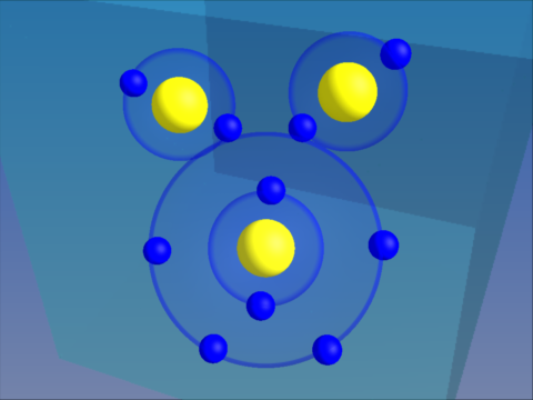

    WATER ATOM animation
    WaterSWISH by Selinita
    WATER ATOM still
    WATER ATOM construction
    Physics ONLY applied to parent "Water" to keep group together during simulation... (see comment above)
    Simples!
    IDEAS
    1.  You could now convert your physics driven animation to key'd motion and turn your attention to the individual elements within each WATER 'atom' using a spin modifier for an interesting animation...
    2. Over to you...

    Wow FENgari, that's mind bogglingly cool! Thanks for the explanantions.
