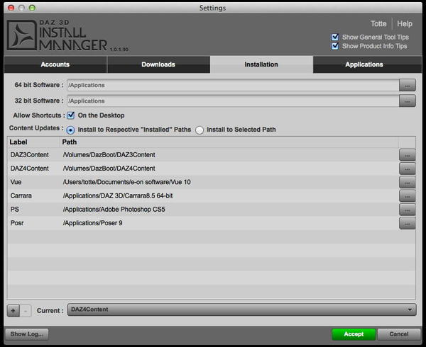

    Can you post a screenshot of this dialog in DIM?

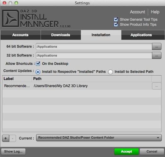

    For me it looks this way:
    557 x 530 - 36K
  • TotteTotte Posts: 14,755
    OK, so your DIM do point to the correct folder.
    Trying to establish what goes wrong.
    It must be something really silly I'm missing here as the content library seems to not work. What formatting are you using on your disks? The normal "Mac OS X Extended with journaling" or are you using something else like encrypted disk formats?
    Maybe it's something as simple as a prefs/setting that is corrupted (seen that before).
    If you go to Menu: Window->Workspace->Select layout..., then Window->Style->Select Style...
    You Don't have to change anything, just accept and OK the one selected.
    Then Quit DAZ Studio and start it again.
