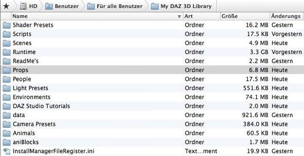

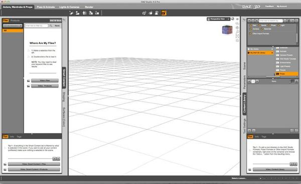

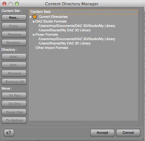

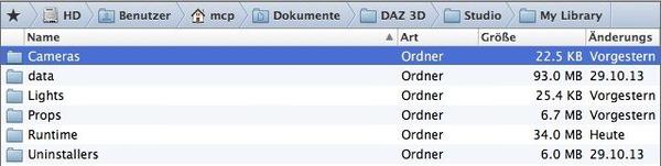

Yesterday I installed Daz3d 64-Bit for Mac. (I use OSX 10.8.5), after this I was not able to find any content that should be there, not in the "Content library" on the right side or anything in the left side "Smart Content". So I thought of a failure and installed all the content I had bought on DAZ 3d by the Daz install manager. And still I had no more content than a little bit of that which I bought.
in the Attachements you can see screenshots of my computer and the set paths.

  • frank0314frank0314 Posts: 15,100
    Not all content is going to show in Smart Content. You probably just need to re-import your metadata
  • gdharregdharre Posts: 0
    Strange, shouldn't I see at least the basics, like Genesis etc? How can I re-import meta data?
    Did you install Genesis Starter Essentials? I'm not sure how to reimport its the same on a Mac as it is on a PC. On a PC I can right click the content library tab, select content DB Maintenence, Re-import Metadata

    Have you checked the settings in the DIM to make sure it's installing things where D|S is looking for them? Your paths look OK, but the two programs do not talk to one another to agree on an installation path. The DIM installation path must match the settings in D|S.

    @gdharre: At what path does DIM install to, compared to where DS is looking for content. I suspect that is the main problem here.

    Everything is installed into, as well the Daz installer installes everything in there:
    /Users/Shared/My DAZ 3D Library
    Can you post a screenshot of this dialog in DIM?
    For me it looks this way:
    557 x 530 - 36K
  • TotteTotte Posts: 15,109
    OK, so your DIM do point to the correct folder.
    Trying to establish what goes wrong.
    It must be something really silly I'm missing here as the content library seems to not work. What formatting are you using on your disks? The normal "Mac OS X Extended with journaling" or are you using something else like encrypted disk formats?
    Maybe it's something as simple as a prefs/setting that is corrupted (seen that before).
