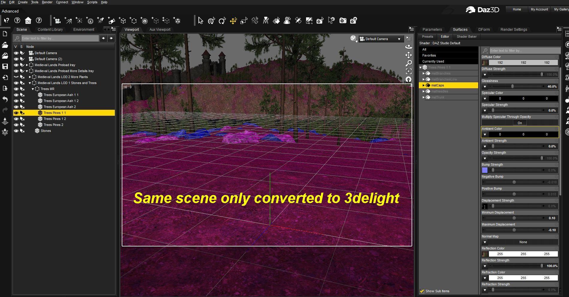

  • IvyIvy Posts: 7,165

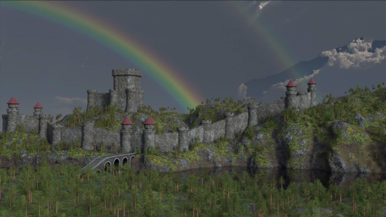

    I bought this set when it was released it comes as iray only . but was able to successfully convert it to 3delight and still make it look as good as iray so i could use it in animation.
     this was using ue2 light dome with glasseye poser  skydome rendered in 3dl

    I think being able to use a skydome with this set in 3dl really makes the scene look better as well I have not had much luck trying to get poser skydomes to look right using iray and when you add a 4k or better hdri  to this set it really comes to a crawl that was one of the reasons i converted it to 3dl and saved it as a 3dl preset

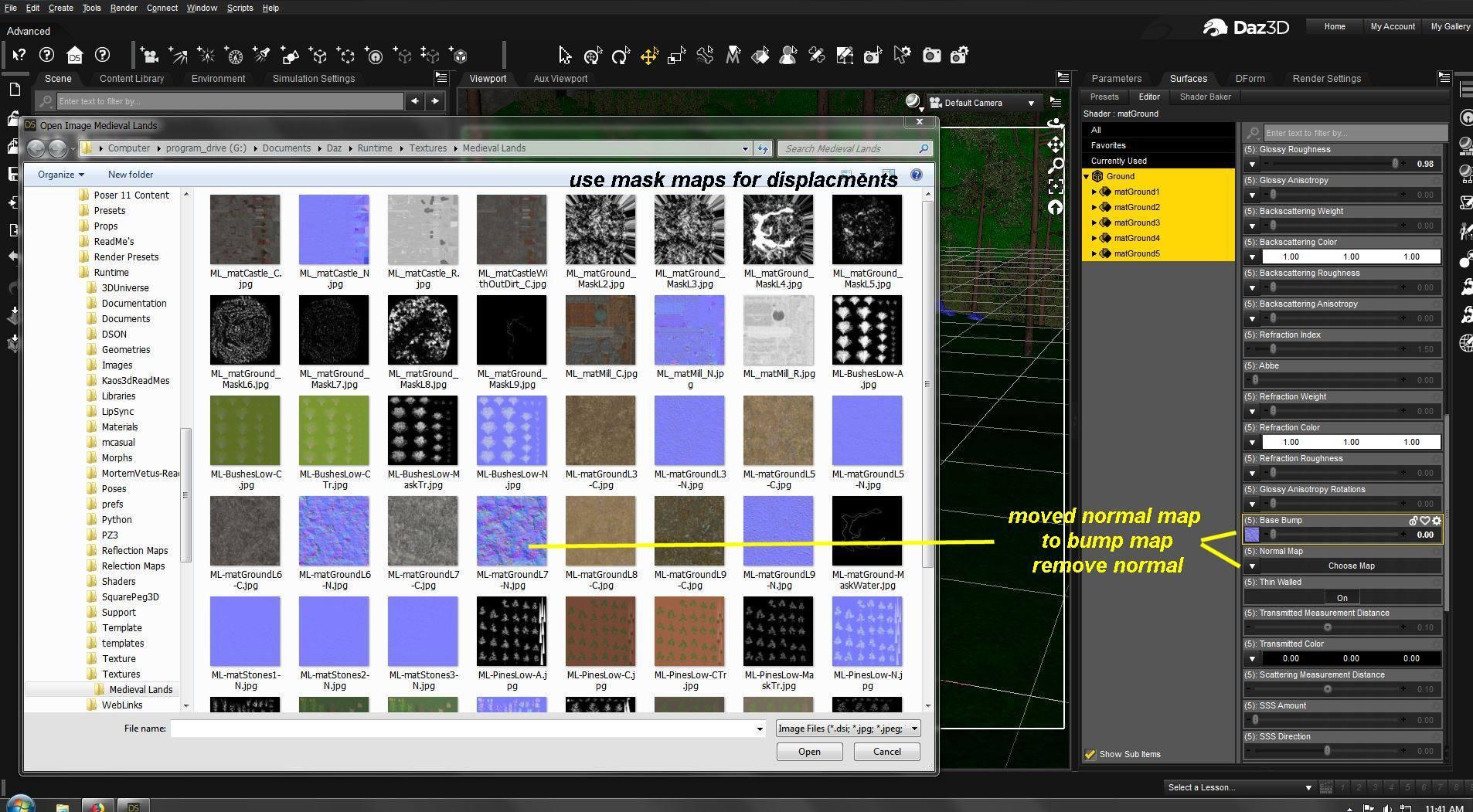

    I dunno if this helps any Sven.  But when i converted my set over to 3dl i swapped the normal maps into the place of the bump map prostitution and moved the settings around 35%  and it worked pretty good  for me that way.  I found that anything that needed displacement maps.  I used the blacked out Mask-maps included in the set. though i did have to do this part of the conversion by hand
    Ok tks for the tips, I'll play around with those grayscale maps. AweSurface has a normal strength slider, but removing limits probably will cause some artefacts (bad normals). Using normal maps in the bumpchannel doesn't sound like an optimal solution, but worth a try:) I could also see how a greyscale version of the albedo map works.

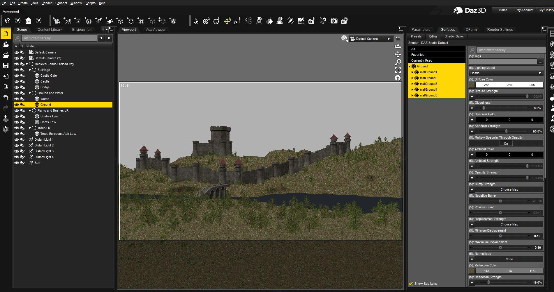

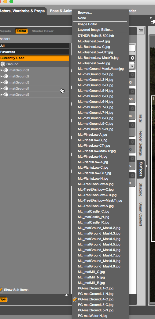

    Ok guys and gals, really need some help here:) This is why I rarely buy IRay products, but now that I did, I'd really like to understand how to deal with this.
    I loaded the Iray version to study how the materials are set up and which maps are used for what. It's basically the ground that I don't understand (and was my major concern).
    I select the ground and look in the surface pane, expand the ground and there are 5 zones as this screenshot shows. Every zone uses the same two maps, one in the base color slot and one normalmap.
    So I click on the base color map and open the textures list. The one that is inserted in the base color slot is called PG-matGroundL4-C. PG meaning Pine Grove. surprise In the list I also find a number of groundmaps called ML, for example ML-matGroundL3-C. ML meaning Medieval Lands. Please have a look at that list, there are several ground maps both ML and PG ones, also a number of ML ground masks, like ML_matGround_MaskL2. However non of them are in use, for the ground only the PG-matGroundL4-C and PG-matGroundL5-N (normal map) are used, so what are the other maps doing in here? And what is Pine Grove?
    I would be so greatful if somebody came up with an explanation, as I'm totally lost here. I need to get the ground to look like a ground and randomly trying out all those options and doing testrenders will take days or weeks.
    Thanks!

    Ivy, your ground seems to use those maps and masks, would you be so kind to have a look at it, my guess is those are set up in LIE? When and if you have a couple of minutes to spare? Tks

    Hi Sven
    If you slide the cut out opacity setting back and fourth you will notice that each of ground mat has its own region there are 5 ground mat and 5 regions 1 for each map, the mask in the iray render I believe is used as a displacement map & for and the normal map I believe that would replace the bump maps normally used in 3dl.  thatss what I used  but you will need to manully set dial settings.   The 5 regions of the ground are covered by its own set of maps 1 difused, 1 normal , and 1 mask.   and it appears to me that is used covers each of 5 area of the ground model. that is how i approached it when i converted it   so  there should be a 1 map each for each of the 5 ground region, then the extra details load their own maps
     I am also just guessing here . but the I think the "PG-matGroundL4-C & PG Pine Grove maps are used for the extra details when you load them . it didn't look like it ws set up as a lie  overlay to me. you can always ask Andrey Pestryakov for clarification

    But but...the IRay set loads with identical settings for the ground regions, except for the tiling, they all share the same diffuse map and the same normal map, I can't see anything else being usedsurprise Ok, I'll go have a check to see if I can figure it out, tks!
    Aaaarghcrying Ok so five ground regions...nine diffuse maps...seven normal maps...eight masks...split into two folders. I'll sleep on it and give it tomorrow, if I can't figure it out by then I'll ask for a refund. There must be some diffuse overlays involved, but the possibilities are pretty much endlesslaugh I managed to add some detail in LIE by randomly stacking a couple of diffusemaps and adding the corresponding masks, however it looked far from the promos, and no idea how to use the normalmaps if I use LIE. Still hoping for some tips. What really baffles me is the Iray material using only one diffuse- and one normalmap, still renders like it should (Did a quick testrender in the viewport). Where the hell are those masks in the Ubershader?

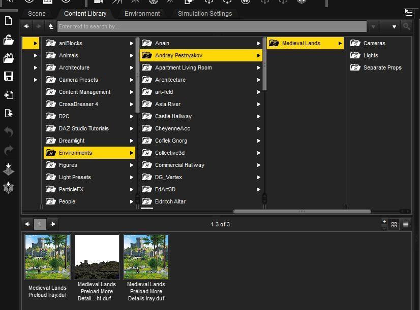

    I used the included maps I just used a free script to change things from iray to 3delight then i went in and manually changed a few maps
     there is 2 folders because the second folder contains the texture maps for the detail preload of this set. plus it also pulls textures from the first folder as well
    here are 2 exact scenes 1 iray preload that comes with the set. andf the other is a screen shot of the same scene with my convertion. so you can look at what I did I'm not sure if this was right or not but the results worked for what I was looking for
    Iray preload
    same scene using my 3delight conversion
    like i said i just converted the iray to 3dl and resaved it as a 3dl preload

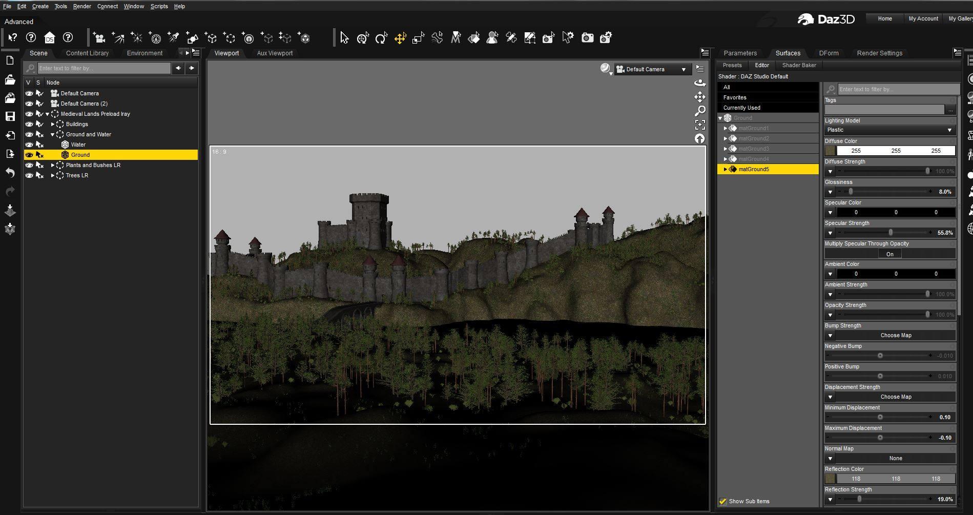

    Look Ivy, I really REALLY appreciate you trying to help meheart I'm just not having issues with the trees, everything is fine, it's the ground I'm having trouble with. If you really want to help, best way would be to tell me exactly what maps you used for the ground in this render that you said was a 3DL render:
    Because this looks just like my IRay preview and this is how I'd want it to look. I can't get this look by choosing one of the seven diffuse maps that has a corresponding normal map and simply put the  normal map into the bump slot. Sorry for being thickfrown, but there must be some diffuse overlaying involved, one way or the other?

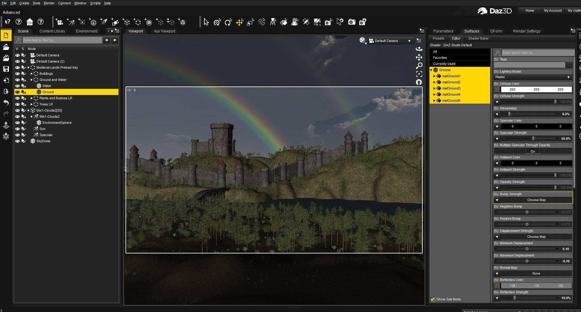

    edited July 2019
    First, Ivy, I want to thank you again for helping me out, I owe you onesmiley.
    Not on my DS machine yet, but have been studying your renders. Very confusing indeed.
    Looking at these two especially:
    First one without the skydome, the ground looks just like what I get, no detail, no rocks. Second one looks like a completely different texture. I get that different light coditions yield different results, but still...
    Could I be so bold to ask you one more thing? Could you confirm that (in your 3DL version) all the ground regions use the same diffuse map PG-matGroundL4-C? This is the one that loads with the original IRay set, and, as I mentioned, in this IRay set every ground region shares this diffuse map, identical settings except for tiling.
    If your version has different maps for different regions, please list the maps used in the diffuse channel for each region!
    Tks  again!!!
