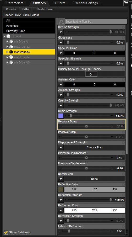

    First, Ivy, I want to thank you again for helping me out, I owe you onesmiley.
    Not on my DS machine yet, but have been studying your renders. Very confusing indeed.
    Looking at these two especially:
    First one without the skydome, the ground looks just like what I get, no detail, no rocks. Second one looks like a completely different texture. I get that different light coditions yield different results, but still...
    Could I be so bold to ask you one more thing? Could you confirm that (in your 3DL version) all the ground regions use the same diffuse map PG-matGroundL4-C? This is the one that loads with the original IRay set, and, as I mentioned, in this IRay set every ground region shares this diffuse map, identical settings except for tiling.
    If your version has different maps for different regions, please list the maps used in the diffuse channel for each region!
    Tks  again!!!
    I think what your seeing is how the different light sources with their raytrace shadow maps react to the texture maps . you have to remember with Uber light environments, you have soft shadow occlusions which give a light bounce similar to what iray gives , which is why I think that why the light dome render looks better than the rest of them.  I really can't explain it myself. but when ever i can i use ue light sources for that soft occlusion light bounce.   but you can clearly see i used the same set with the same setting just different light sources. and every result was different.
     I used this free iray to 3delight converter script , which does a decent job of map placements . https://www.daz3d.com/forums/discussion/139326/irayto3delight-conversion-script/p1
    Here are the texture maps you requested for the ground are list as such
    ground>
    Matground1  - Base map  PG-matGroundL4-C  with the Diffuse Roughness dial set @100% - Bump map is PG-matGroundL5-N  dial set @ 14%
    Matground2 - Base map  PG-matGroundL4-C  with the Diffuse Roughness dial set @100% - Bump map is PG-matGroundL5-N  dial set @ 14%
    Matground3  Base map  PG-matGroundL4-C  with the Diffuse Roughness dial set @100% - Bump map is PG-matGroundL5-N  dial set @ 14%   Reflection Color PG-matGroundL4-C  with the Reflection Strength dial set  @ 100%  (see screen shot 1)
    Matground4  Base map  PG-matGroundL4-C  with the Diffuse Roughness dial set @100% - Bump map is PG-matGroundL5-N  dial set @ 14%   Reflection Color PG-matGroundL4-C  with the Reflection Strength dial set  @ 100%
    Matground5  Base map  PG-matGroundL4-C  with the Diffuse Roughness dial set @100% - Bump map is PG-matGroundL5-N  dial set @ 14%   Reflection Color PG-matGroundL4-C  with the Reflection Strength dial set  @ 100%
    water map>
    defuse color black @ 100%- Glossiness dial set @ 94%  -     Specular color  white- Specular strength  100%  Bump Map PG-matWater-N - dail set @ 50%  I also noticed the reflection color appears to be dark blue and that is set @ 100% see screen shot 2
    508 x 912 - 73K
    504 x 904 - 70K

    Ok now I know what texture to use, and that there is no overlaying involved, so will go from there;) As I use aweSurface with scripted pathtracing the convertion script won't work, so I'm used to manually converting everything, including the dfault 3DL shaders. Normally there are no issues converting 3DL shaders, but the independent tiling together with overlaying with the IRayUber will always be tricky.
    So, since the ground uses only one of the nine included diffuse/albedo maps, any idea why they are there? surprise...laugh Not to mention the maskslaugh
  • IvyIvy Posts: 7,165
    if you look at the other props and stuff those other maps are for the castle props and trees & rocks ( with out going in and looking ) I believe there are 3 texture folders for ths set. The mask would be used for cut out opacity in the windows and bridge base props & normals maps used for bump in tiling for iray rendering.  thats has been my understanding looking at the layout

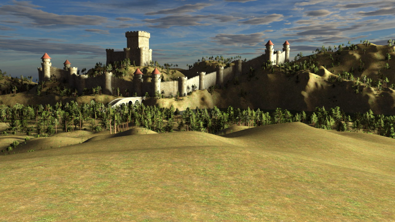

    So, still a big mystery how to set up that ground to look like the Iray version...that groundtexture is just plain vegetation, no rocks or anything, so in my world changing the lighting can't magically make the rocks show. Anyway, made an attempt to make it look descent without the rocks, made a displacement- and a specular roughness map to give it some depth. Will continue tweaking, and may test the things Wendy suggested, or use LIE and make my own masks. Testrender nr 2:
    And just to test something completely different I tried some cliff shaders and stripped the whole thing;) Those are customshaders and won't convert easily to aweSurface so used regular 3DL, quick and dirty testrender:
    Now working on the added detail stuff. Looks like those extra props will cover most of the center area, so maybe it'll work in the end:)
    1280 x 720 - 2M
    1280 x 720 - 2M
    Post edited by Sven Dullah on
    And after having a new look at the promos I'm willing to give up. It's just not possible to get this look using one albedo- and one normal map...no way! Something going on under the hood and I just don't know Iray that well to figure it out. I've searched hi and lo inside the IrayUber trying to understand how this is done. Still convinced that the ground uses atleast three layers with masks.
    The link is in my opening post if someone want's to look at those promos.

    Tks again to everybody who helped me out with this set! Even if I can't recreate that ground with 3DL shaders it's still a nice set and useful for many things. Will think twice, though, before purchasing another Iray only product;)
    Oh I forgot: Tks @agentunawares for sharing your beautiful and high dynamic range HDRIssmiley
