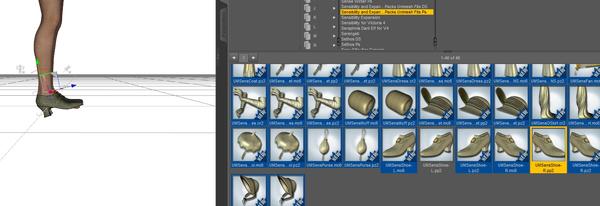

Help! When I add shoess from the extension (I do have Sensibility for Victoria) they just go below my character (see attached). The only place I can find the shoes are under Poser Formats/My DAZ3D Library/Props/Sensibility and I have the pose under Poser Formats/My DAZ3D Library/Pose/Sensibility. For other items I try to add I get a request to fit the item to the character, but this doesn't do that. I'm so lost. Any help would be appreciated, even if its to send me in the direction of where this question has been answered before (I tried doing a search).

  • sralosangelessralosangeles Posts: 0
    edited October 2013

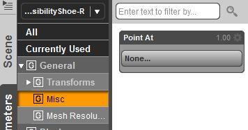

    Thanks for the quick reply I'm not sure how to answer the first question. I'm using a basic female and when I put clothes on it ask me to fit to something, and I choose Victoria 4, which has always worked before. I do have the figure selected when I click on the prop shoe. What's really weird is doesn't give me the "fit to" option under parameters. I broke it. :-(

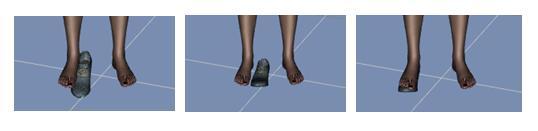

    Thank you. I will definitely try that. Since I'm being a pain in the rear, if you don't mind I have one other question. When I try to move the shoe on top of the foot it goes behind it. Is there a way for me to bring it forward above the foot? I've had this issue with other items, but ended up rearranging things to accommodate the problem.

    Sorry this has taken me so long. I've been slammed at work. What I can't figure out is how to get the shoe to show on top of the foot versus hidden by the foot. I understand why it won't fit to the foot, but I can't resolve this particular issue. I've attached a screen shot that shows what the shoe looks like when I import it, if I move it up, and if I try to place the shoe on top of the foot (which it doesn't do).
