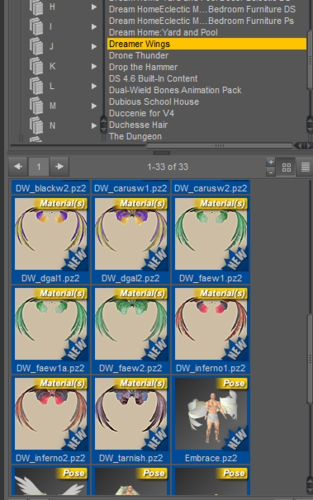

    I'm thinking your CMS is not running or your CMS Database has crashed. Here is my Dreamer wings in Products View. Does Smart Content work at all for you?

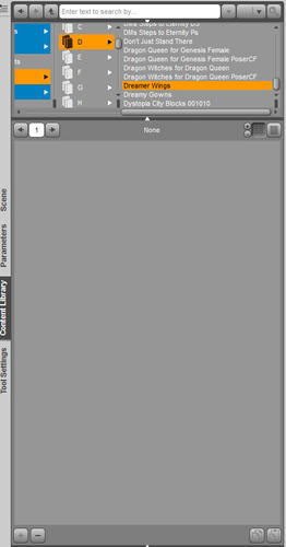

    I think the idea about the content manager crashing or not working is the likeliest option. I assumed they would be in the Poser format section as the wings and the poses are there, and i've looked in every category of the poser content. The screenshot you posted shows exactly what I have done (i.e. searching products) but whereas you then get a load of files, I get nothing! My smart content seems to be working OK, although come to think about it, nothing else I purchased in the same order has appeared in it (Space base, Crimson Throneroom). Just like the Dreamer Wings, Crimson throneroom and Space Base also appear in the product listing, but when I click on it nothing shows. I did manage to find them in the database though. I've attached a screenshot to show what I get.
    If my content manager has crashed, what do I do? Re-install DAZ?
    In the poser formats, where do you think the textures might be? I've looked in Figures, Materials, Pose (I found the poses there), and Props!

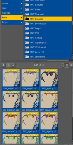

    First you might need to Import metadata for your new items.
    Second the Materials are in Poser Formats> Poses> MAT Dreamer as shown here.
    373 x 736 - 89K
  • AdrianSAdrianS Posts: 77
    OK thanks - I've found the material files now. How do I go about importing the metadata?
