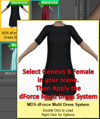

    The problem is that you're never adding the actual wardrobe component. Add the item called "MDS dForce Multi Dress System" first, because without that, none of the presets, shapes or materials do anything.

  • GordigGordig Posts: 10,807
    edited July 2019
    I don't know what the script you're using is meant to do, and don't work with scripts inside Daz myself, so I can't say for certain. Try double-clicking this icon:
    If you don't see the dress after that, then there's something wrong.

  • Ah - that image does not appear on my installation. I will see where it is. Thanks for giving me a direction!
  • I thought I would report back, in case anyone has this same problem.
    I reinstalled, without a resolution. So I went directly to the directory. In there, I can see the image and the script that Gordig mentioned in his post. However, it is not in my DAZ display. So I dragged it directly the figure in the viewport. That put a black dress form on the figure. Then I went in and double clicked on the blouse form I wanted in the content library panel on DAZ. I could not run the other scripts from inside, so any script, I just drag and drop directly from the file. Everything else, materials, etc., works fine. I am not sure why, but I am at least working with the software. Thanks for the help!
