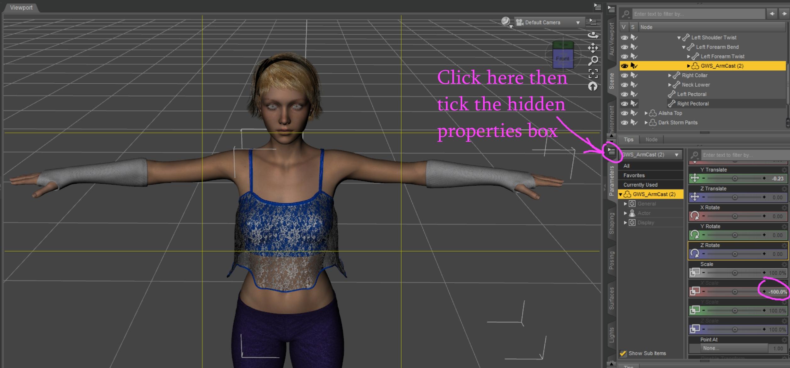

    1/ Unparent the cast from G3 and put the G3 character in the zero pose
    2/ Select the cast, then show its hidden properties, by selecting 'Properties', then click on the small icon with 4 lines (see image, and click on the image to get it full size)
    3/ Tick the hidden properties box
    4/ Now look at the properties for the cast and find the greyed out 'X scale', and replace the 100% with -100% (that's negative 100 percent)
    5/ The cast should now be on G3's left arm, where you now have to parent the cast to the forearm. If it's not a base G3F you will need to position/scale the cast to fit
    6/ Done. Now pose your G3 and it should all work.
    EDIT: Make sure you go back and de-select show hidden properties.
