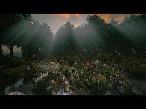

  • StezzaStezza Posts: 8,859
    the christmas, new year period gets me away from creating stuff and helps recharge... maybe time for a break. smiley
    I bought FlowScape yesterday $15AU .. it's categorised as a game but does 3d landscapes with props... I have found it good place to go and tinker and to get away from it all yes
  • DiomedeDiomede Posts: 15,401
    Flowscape looks pretty cool.  I should check it out.
  • WendyLuvsCatzWendyLuvsCatz Posts: 40,442
    wow that does look cool, I see it does not export mesh but assume does renders I hope maybe 360 renders?

    I bought Flowscape now too devil
