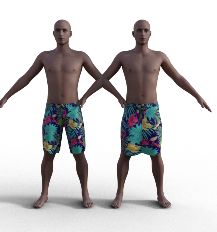

And did a test render with a Genesis 8 figure and the swim trunks honestly look like a dress. What am I doing wrong?
See attachments, for promo images, and my renders (last two).

    Von Hobo, you need to run a simulation after you pose the G8M figure.
    Here I've simulated the shorts on the left, leaving the right pair unsimulated.
    729 x 782 - 478K

    But keeping it simple, try this: load your figuure in Studio, add the dForce clothing, then pose the figure. Now, if the clothing touches the floor you need to add a simple floor (like a primitive plane, exactly at ground level).
    Now find where your dForce panel is and hit the blue 'Simulate' button. And wait (make a cup of coffee or something).
    If all went well, your clothing is draped, and you can remove the plane, and add hair, props, etc.
