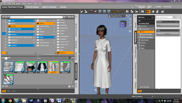

No matter what I do to alter the genesis body shape, the breasts shows through Mad Nurse for Genesis Female. Applying Smoothing modifier to dress doesn't do anything either.

    Here's a screen capture of the trouble.

  • HastyDaveHastyDave Posts: 109
    It seems to load with the Collision Iterations set to zero. Select the dress, then Parameters tab -> Mesh Smoothing and increase the Collision Iterations.
  • grpruettgrpruett Posts: 255
    That was it. Thanks.
