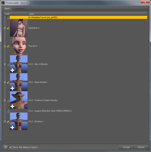

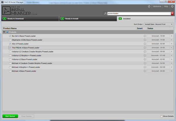

    They should have powerloaders. See my DIM image. The specific ones you're asking about have check marks (on the dim image, not the PL image).
    1175 x 808 - 280K
    785 x 790 - 171K
    Post edited by Lissa_xyz on

  • barbultbarbult Posts: 27,251
    Vaskania said:
    /edit
    They should have powerloaders. See my DIM image. The specific ones you're asking about have check marks.
    Thanks for the help and pictures. Those packages were installed by the DIM, but they don't show when my PowerLoader opens, like they do in yours.
    Are you sure you're using the Victoria 4.2 icon and not the V4.2 to V3 icon? The one you use shows only her head, and the other is a full frontal.

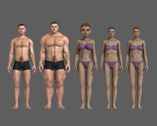

    So far so good. I have M4, V4, F4, S4, G4 straightened out. Now I have to do Reby Sky and Aiko 4.Do they look right? G4 seems very tall!
    1690 x 1352 - 552K
    edited October 2013
    She looks right. I think it's her balloon of a head and slightly lengthened torso that makes her look tall.
