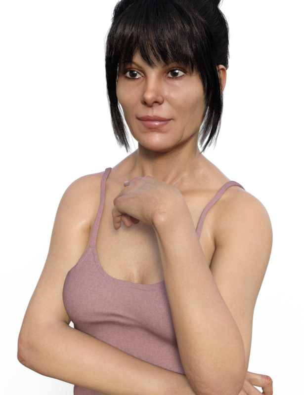

    Here's Alexandra 8 with her Translucency Low setting and the default "RuinsB" HDRI and default Iray render settings - but with the Environment Intensity increased to 1.5:
    Due to the increased lighting, I think she's a bit shiny here, so I'd also recommend going to the Surfaces Tab, select her skin, and decreasing the "Duel Lobe Specular Weight" a tad. .40 should look nice, imo.

  • Wow, the image looks really nice. That's what I wanted.
    Thank you very much for all of your comments. I'll read through the comments over and over:)
