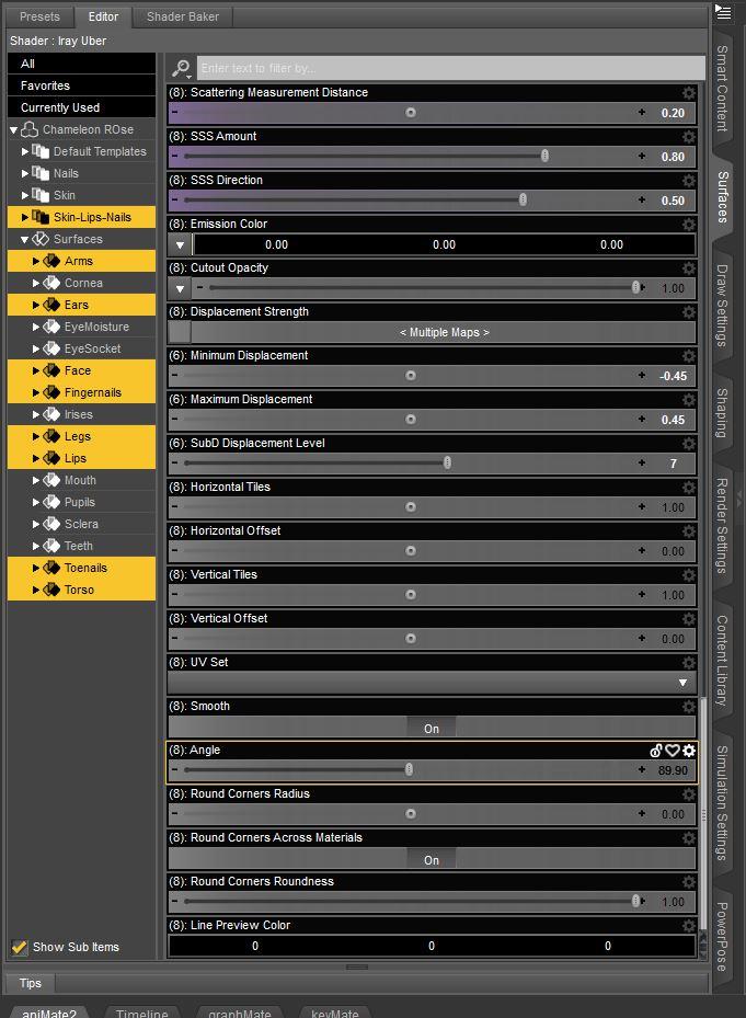

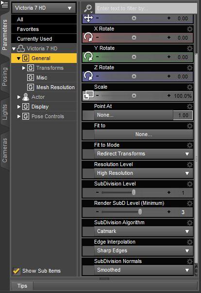

    Go to the parameters tab, with you figure selected as shown here and reduce the number in "Render SubDivision Level":
    Some props and outfits and figures that use displacement maps will have subdivisions set up in the surfaces. You can change that subdivision by selecting the proper material in the surfaces tab shown here "SubD Displacement Level":
    Hope this helps!
