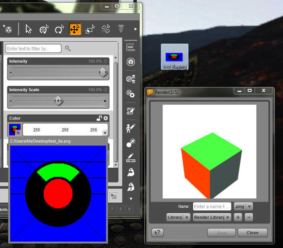

Ever since my first tests with the UberEnvironment2 I've been troubled - I just cannot seem to get rid of this belief that the image plugged into the Light > Basic > Color should be an angular mapped image, not a lat/long mapped image. Every piece of documentation (and the lat/long mapped HDR .tif images that come with DS4) tells me I'm wrong, but every test I do contradicts the documentation.
I mentioned this on one of Casuals threads (don't go and read the thread till you've tried the test below though!), and was shown some experiments that persuaded me that I was wrong.
However, I've just done it again. If lat/long mapping is correct, please can somebody explain the results of this very, very simple test. I'm not even including screenshots as I'd like other people to try it:

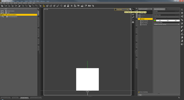

1) Open DAZ Studio 4 (I'm still using 4.5.1.6 64-bit)
2) Create > New Primitive > Cube
3) Load the UberEnvironment2 (Light Presets > omnifreaker > UberEnvironment2 > !UberEnvironment2Base.duf)
4) Apply a lighting set (Set HDR KHPark.duf)
5) Set the highest quality (Set Quality 4xHi.duf)
6) With the UberEnvironment2 selected go to the Parameters tab > Light > Basic and set Environment mode to 'Ambient (no ray tracing)'
7) Replace the Light > Basic > Color image (if you used the KHPark.duf it'll be set to OmKHPark_EnvM.tif) with the attached 128x64 jpg image.
8) BEFORE you render (do this bit in your head as you won't see anything in the preview) look at the image attached to this post and write down what colour each of the cube faces should be - front, back, top, bottom, left and right - if this is applied using a lat/long mapping.
9) Render from several different angles and note down the actual colour of each face. My guess is that it doesn't match what you'd predicted... Or is it just me?
*I just noticed that as well as screwing up all the links to specific posts, the forum software change a few years ago didn't keep the same paging. So even references to a post by its position on a specific page are wrong.And in posts that quote previous post (which included quotes) everything is totally screwed - you can't tell which bits are quoted and which bits are the reply

    Where you say *before the render.. etc*, I'm not seeing any actual color being projected onto the cube. I only see color if I render.
    /edit
    Those other 2 you posted come out in a lovely shade of 'deadly pink'. Ouch, my eyes.

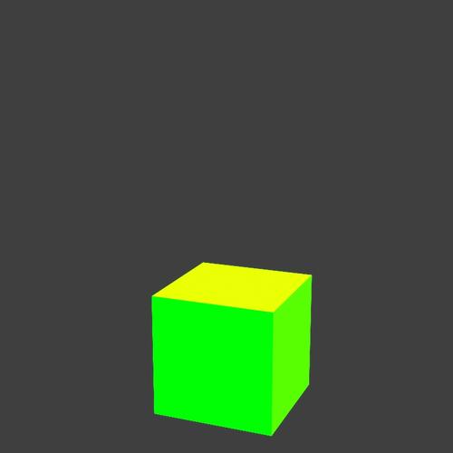

    Correction: my actual results with just the UE2, cube, and the OP image (green with red band at top and bottom) were:
    - Top/Bottom: Yellow - 236,255,5/234,255,2
    - Back: Yellow - 255,255,2
    - Front: Green - 0,255,3
    - Left/Right: Green - 88,255,4/89,255,3
    Colours recorded by doing renders from top,front,etc cameras, saving as PNG and checking the colours in GIMP
    Using the IBL Transformer with IBL file(UE2 radiobutton), no env sphere, no AO:
    - Back/Front: yellow
    - Left,right,top,bottom: green
    Using UE2 with IBL file (Auto radiobutton), no env sphere, no AOn:
    - Top/Bottom: yellow
    - All sides: green
    (didn't record precise colours when using IBL Transformer, since the green/yellow seems to indicate the same issue as the standard UE2)

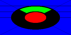

  • 3dcheapskate3dcheapskate Posts: 2,728
    Try this image.
    I haven't tried this one yet, but here's what I'd expect:
    - If the mapping UE2 applies to the color image is angular I'd expect:
    front=red,
    top=green,
    back=blue,
    left/right/bottom=black.
    (Since the image is an angular map I'd expect the colours to be near enough spot-on (i.e. red=255,0,0, green=0,255,0, blue=0,0,255, black=0,0,0)
    - If the mapping UE applies to the color image is lat/long I'd expect:
    front=red, but with a bit of green and black - say 236,20,0
    left/right=black, but with a bit of green and maybe a touch of blue - say 0,5,5
    top/bottom/back=blue, the top may have a touch of green (say 0,5,255), bottom/back a touch of black (say 0,0,250)
    (this assumes that UE2 applies some blurring/convolution to the image, which seems to be the case from the tests I did with the images in the first and second posts.
    Off to try it out now... back soon... (I promise I won't edit this post!)

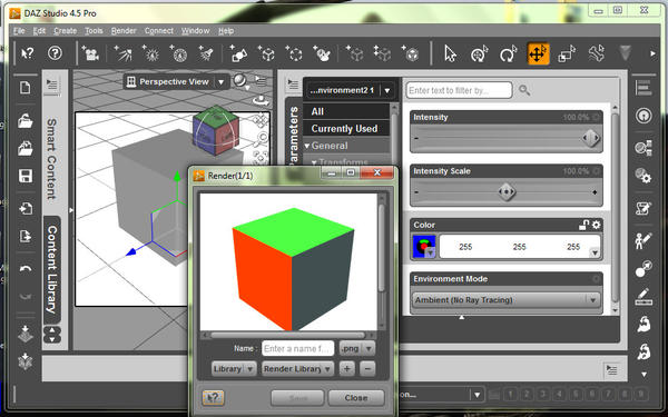

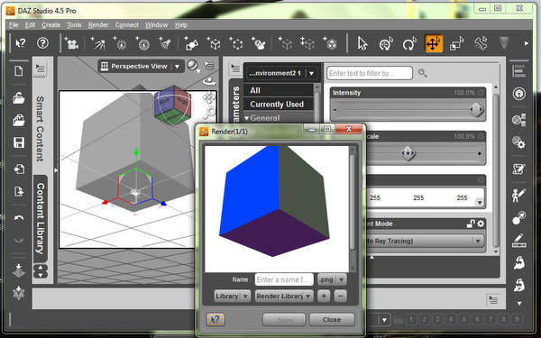

    My results:
    -Front=reddish-orange
    -Top=pale green
    -Left=mid/dark-grey
    -Back=blue
    -Bottom=dark purple
    -Right=dark grey
    942 x 588 - 134K
    941 x 588 - 139K
    edited September 2013
    Resized the image in GIMP to 300x150. Fired up DS4.5 again and applied the correctly sized image. Here's what I got. Looks the same to me. I'm fairly sure already (from lots of empirical testing) that the UE2 takes whatever size image you plug in and converts it to the size it needs - whether that's a 2:1 lat/long or 1:1 angular mapping ratio is a moot point.
    300 x 150 - 1K
    765 x 543 - 83K

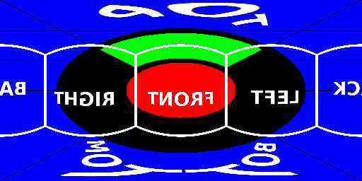

    These two images are how I determined what to expect from Fuzzy Gnome's test image (except I did it in my head). The most important point is the faces which would clearly be different colours with the two mappings, even after taking account of any blurring/convolution the UE2 applies - for this case I'd say it's the top and bottom.
    512 x 512 - 93K
    512 x 256 - 51K
    Post edited by 3dcheapskate on

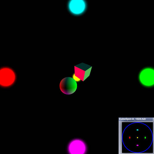

  • Takeo.KenseiTakeo.Kensei Posts: 1,303
    I didn't run the test but first thing I'd say is that you didn't prepare your image for UE.
    Read at the bottom http://www.omnifreaker.com/index.php?title=UberEnvironment
    Get Omnifreaker's utility and convert your jpg first
    Second point : like Adam said, colors are mixed. It seems to me you're awaiting a single color taken from the normal of the cube which is not the case
    Thing is UE samples over a half sphere and averages the result. Eventually, If we could control the sampling angle and narrow it to a few degrees you could get what's in your mind but there I'd ask myself wether light behave that way
    Thanks for the reply. Totally agree on your first point - none of the test images have been prepared in accordance with those instructions. I can accept that, based on that point alone, none of the tests I've done are valid.
    Very simple to resolve - the instructions are fairly precise, so I'll go away and correctly prepare my test images. The biggest problem I see is coming up with a good test image in the first place (your comment that UE2 takes the average from a complete hemisphere should be very helpful in that regard - many thanks)

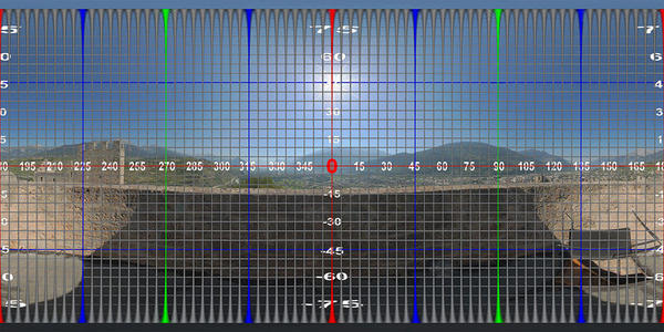

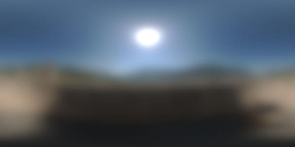

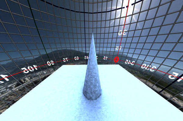

  • HoroHoro Posts: 11,407

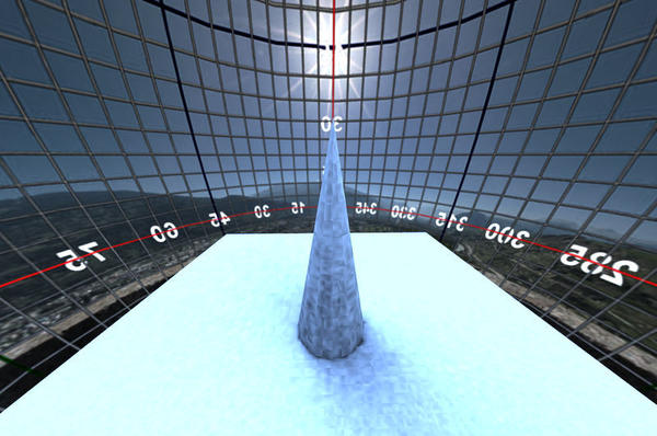

    This is a very interesting thread. I've found out 2 years ago that the light and environment spheres are 35° offset in azimuth. I have not yet tested elevation - or colours. Since the light - the 96-bit per pixel HDRI (whether hdr or tiff) is blurred by specular convolution colours tend to get mixed.
    The first render shows that the shadow is offset from the light. The second has the hdri/env sphere rotated so that the cone points to where the bright light actually comes from.
    The third picture made the environment sphere. The grid was modeled in Bryce as a sphere, the camera set in its centre and around an HDRI (Tourbillion Tower), tone-mapped as backdrop. The 6 cube faces were rendered in Bryce and assembled to a spherical panorama.
    The last picture shows the HDRI used, specular convolved with a Phong exponent of 250 (16 seems very low to me, approaching the effect of diffuse convolution.
    This is how far I came. I used to offset the small HDRI against the env-sphere right when creating the set for using in UE2. In the long run, I think that is not a satisfactory method.

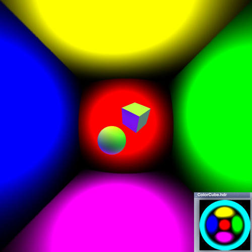

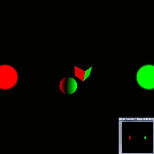

    As far as testing is concerned, a sphere gives a better representation than a cube. A cube has to be aligned precisely otherwise colour mixing occurs. There is also colour mixing on a sphere, of course, the direction from which the light shines can be better seen.
    The size of the color lights is also very important. Wide light sources mix sooner than smaller ones. It is therefore difficult to get a valid test using a specular convolved HDRI.
    This is shown in the 4 render below. I apologise these are Bryce renders, because (1) I'm a total DS nut (though I'm about learning it a bit; (2) Bryce IBL works flawlessly because there is only one image: the HDRI produces the light and the backdrop (and can create the specular map and export HDRI, specular map and tone-mapped backdrop in several projections); (3) I know how to use it.
    There is quite a wide camera angle, the extreme wide angle lens is used to show a lot of the backdrop. The inset at lower right is the HDRI used (shown as an angular map - Bryce can use the HDRI in the angular map and spherical projection).
    Example 1 shows how colours are mixed when using an HDRI with wide lights.
    Example 2 shows the same setup with an HDRI with small lights (unfortunately with the colours at different places).
    Example 3 has only two small lights left and right.
    Example 4 has the lights above and below.
    600 x 600 - 12K
    600 x 600 - 13K
    600 x 600 - 16K
    600 x 600 - 35K
