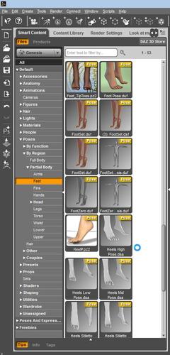

    Check your Smart Content tab and see if there are any high heel foot poses that may have come with other products:
    1. Select Genesis
    2. Go to the Smart Content>Files tab
    3. Click on Default>Poses>by Region>Partial Body>Feet
    As you can see, I have lots of them from various shoe products I've purchased. dx30 shoes always comes with a "FootSet" pose that works perfectly with these boots, but other high heeled foot poses will work. Hope you have some of these foot poses.
    488 x 1018 - 86K
