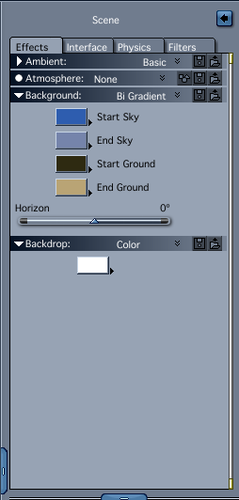

    Also, the sky light enabled in the render room relies an awful lot on the surrounding elements of the scene requiring one of the following:
    Either a Background scene
    or a background image
    or a background color or gradient
    either of which need to surround the scene.
    I really love Cripeman's Global Illumination Intro video tutorial! Using his method, you can use a bi-gradient to control the colors of the illumination. And if you don't want those value to show in the render, you can block it with a Backdrop image, color, or a different bi-gradient.
    I think you're all missing the real clue in the OPs post. He said that the "sky" is white, and so is the "ground."
    I suspect he used the color gradient in the scene's background, then changed the colors from the default blues for the sky, and the default browns for the ground, that could be his problem with the brightness.
    My suggestion to the OP is to set the Background color back to it's default, then in the scene's Backdrop place a white color if that's what you need for the render.
    You can use other functions for a more realistic looking light with the Skylight function, such as an HDRI in the Background, or a Realistic Sky in the Atmosphere.
    254 x 532 - 25K
  • DartanbeckDartanbeck Posts: 22,148
    You are so right, ep. I totally missed that. Yup. White means bright light! ;)
