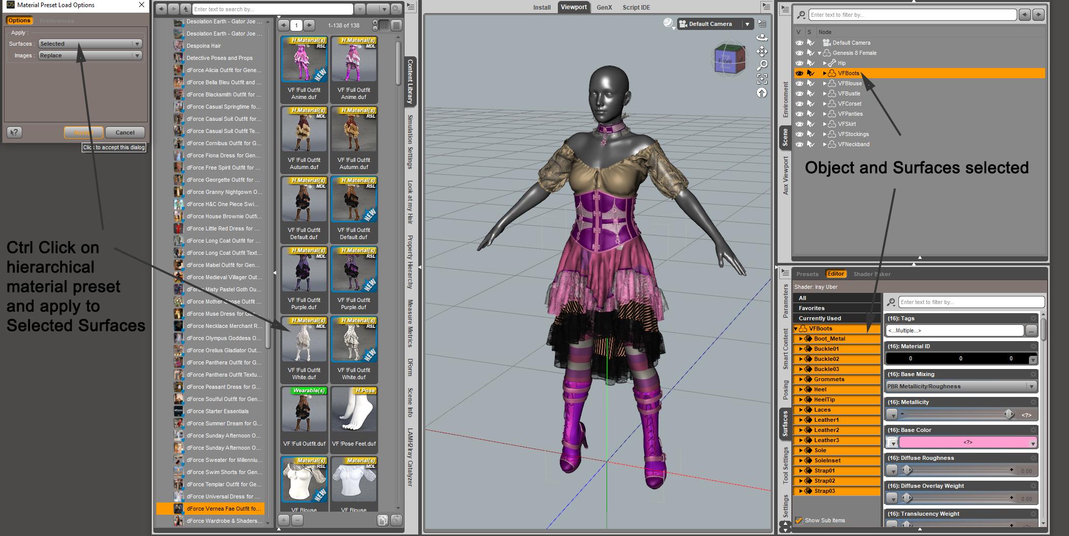

    You need to have the selected pcs also selected in the Surfaces tab like when you apply a shader. Not sure if this works when fit to another figure though.
    Eureka!!! It does seem to work when I have East Meets West autofit to G8Female, learn something new every day!

    Selecting the surfaces was the magic answer!! Thank you for this tip. This is incredibly useful.
    Edit: I'm adding this screen capture so I can refer back and remember how to do this.
    2106 x 1056 - 1M
