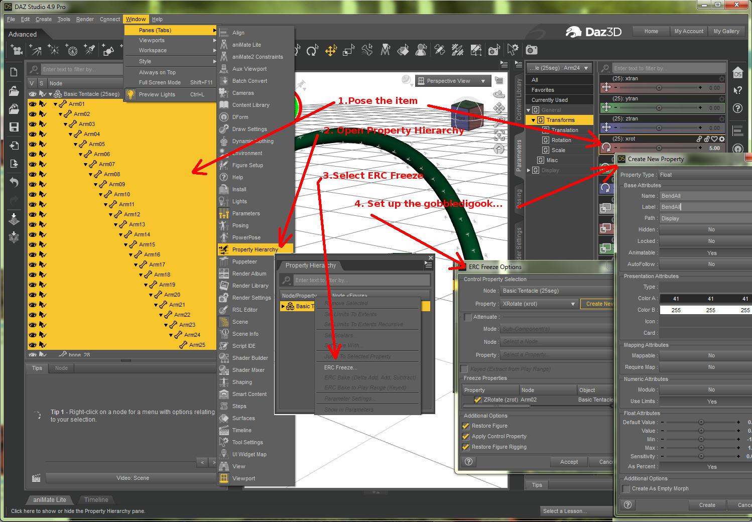

    Just opened DS4.9 and tried this ERC Freeze thingy.
    It looks quite easy (just as SY said), but I'm obviously missing something in (refer to attached collage here...) step 4,"Set up the gobbledigook...".
    So what do I need to do to add my "BendAll" dial slider (to control xrot for Arm1-25) to the root node ("Basic Tentacle (25seg)") ?
    1498 x 1040 - 269K
    Post edited by 3dcheapskate on
  • After years of hand jamming code I discovered easypose. I loved easypose, but like you said it doesn't work on daz native files. I just got turned on to the ERC freeze in daz studio and it's just as good once you get the hang of it. Highly recommend sickleyealds character maker tutorial
  • Just opened DS4.9 and tried this ERC Freeze thingy.
    You need to right-click on the property you want to drive the ERC, or create a new proeprty to drive the ERC. It looks as if you are right-clicking on one of the existing rotations, which isn't usually desirable for this use.

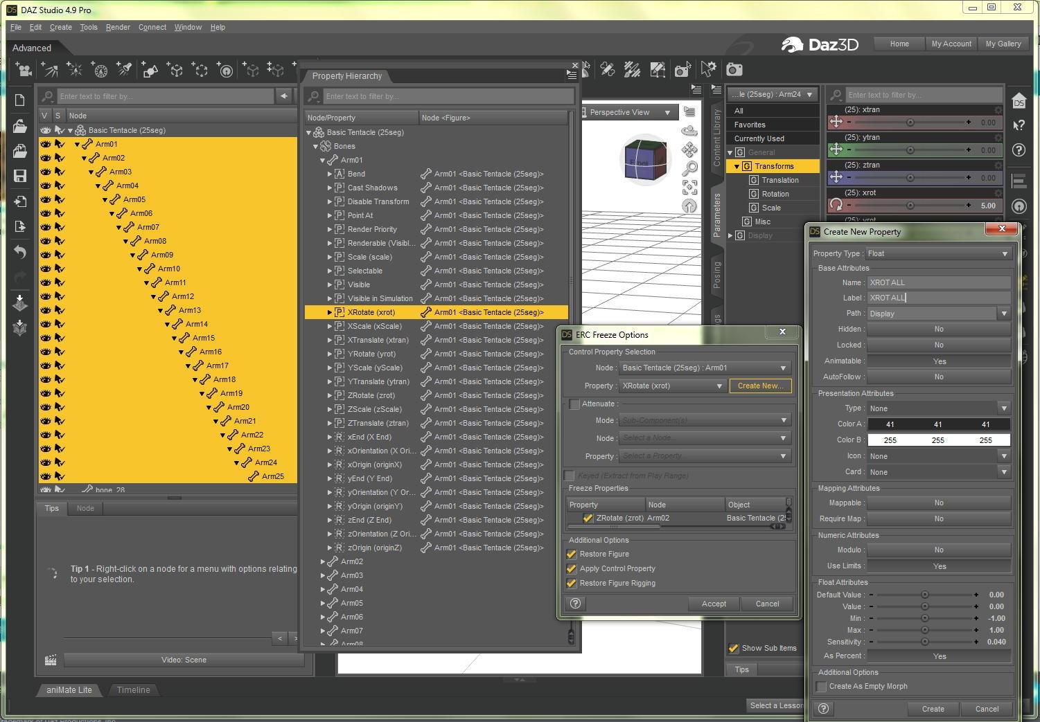

    Okay, so I think this is how I create my master slider...
    ..and then I say which things are slaved to it, i.e. just the xRots of Arm01 to Arm25)...
    So according to the Property Hierarchy I now have an 'XROT ALL' controlin bone 'Arm01' (I can't seemto add it to the root node, 'Basic Tentacle (25seg)'? - edit: yes I can!).
    But I can't find it on the main UI Parameters or Posing tabs. Found it/them - see next post
    P.S. I'm using an old DS (4.9.4.117(64bit) from the beta channel?) as that's the most recent DS I have installed
    1501 x 1043 - 257K
    1194 x 1036 - 236K
