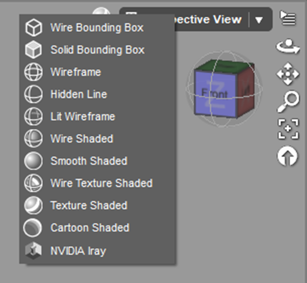

    They look similar, but not the same in your screenshot. Here is a screenshot of the choices for reference.

  • Yeah when I click on the little the smooth and texture looks just like the cartoon shaded icon, I'll have to post another image tonight.
  • See, all three are all the same and you seen the bottom right one has the right icon on it but when I click on the list its just like the other 3 and if I click on it, it would make it look just like the others and I can't change it back.
