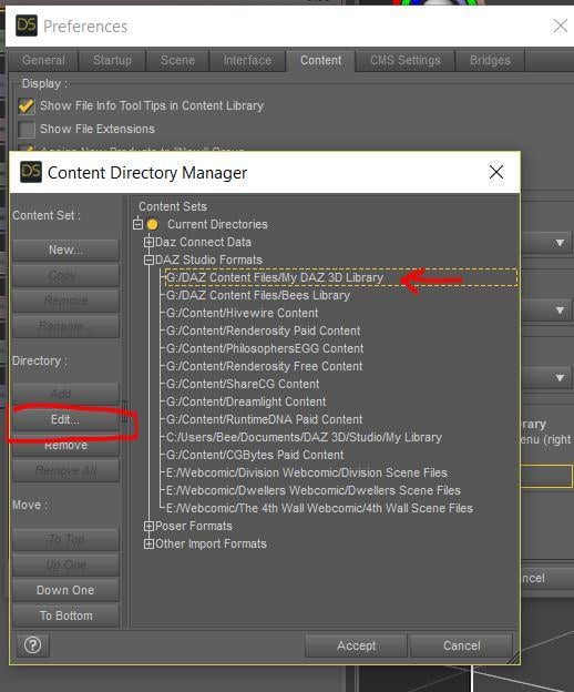

    I looked at the  Edit> Prefrences (or press F2), Content tab, then Content Directory Manger button. But how do you direct the content
    to your folder in D: Drive. I saw i could add new but what do i write and make sure it installs there and not in C: Drive

    If you click on the actual folder name, it will give you the option to Edit. That is the preferable way.
    Make sure you also change the folder name in Poser Format, for all that older content.

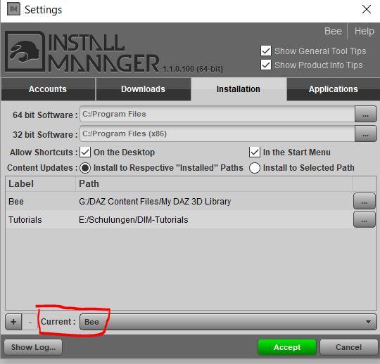

    For downloading through DIM, you can either use the script, or change the setting manually in the DIM preferences (can't make a screenshot of that at the moment, please let me know if you need one.).

    I tried changing the setting in DIM and when i started downloading i noticed it downloaded to my C: Drive instead of
    to the D:drive that i had entered as an alternate path!?

    As for Dim, have you made sure that you have selected the new installation path as "Current"?

    You will need to move or uninstall/reisntall the content - DS will cope with moving, DIM will for the most part (if, in the Installation tab of preferences, you tell it to install to the current directory not the original install location) but you may have occasional issues when an update removes or renames a file.
    Make sure that you have set DIM to use the new path - you can do that with the Current option in the Isntallation tab of preferecnes, or you can click the details check-box in the main interface and change the path there.
