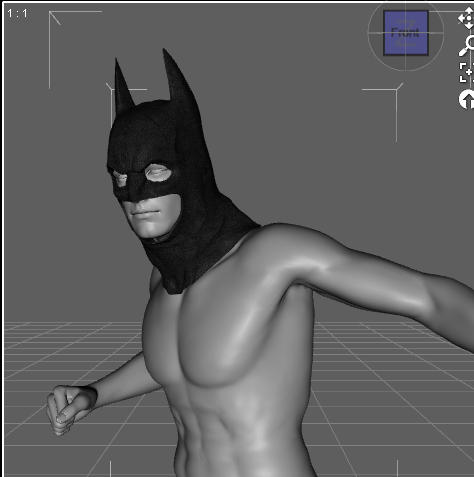

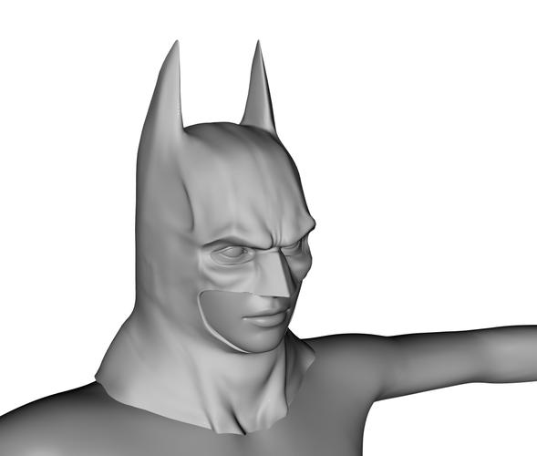

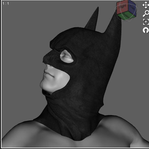

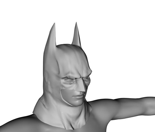

I did some quick refit for the cowl and met following problems:
- Even when cowl conforms to default Genesis well (see picture 1), when I apply M4 iconic shape (picture 2), eyebrows deform. It can be fixed in Hexagon with smooth brush and made into M4 proper morph but autofollowing might give some problems.
- I had to fix weightmaps a bit. Tops of pointy ears and brows/cheekbones, had to be filled 100% to follow properly but this was rather simple fix.
- The bend of neck is slightly off. Some weight correction probably will help it too.
- To preserve original morphs from cowl some extra steps will be needed.
Most of those problems can be fixed with Hexagon smooth brush (and made into morph) or DS weightmapping brush (and saved into model).
To do a initial refit I followed JoeQuick's method (scale, reposition, slight correction of the cowl, using transfer utility with default Genesis; it is possible to use Reverse Shape refit if you have M4 Iconic shape for Genesis without those steps but results are somewhat worse).

And nice comparison renders, the one on the left is what I'm going for. :)
First render is default Genesis, second is Genesis with M4 iconic shape added. If you don't need M4 shape and only default Genesis, it works pretty well as it is, as soon as you weightpaint tops of pointy batears and some cheekbones.

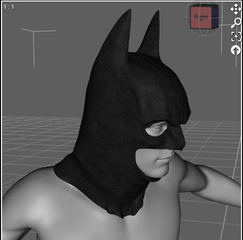

I understand the OP not having money, but actually, SRMS works well. The bodysuit and dress both cover the entire head of the figure, so when used in conjunction with the M4 morph or clone, excellent results are possible with hats and cowls.
Shown on Michael 5 and using this free earless morph, since the original item has no clip fixits.

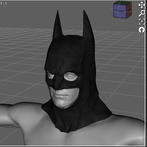

Sure, here you go. Converted with SRMS bodysuit template, saved to library, and reloaded and used with the same earless morphs on Michael 5. Nose point and chin-gapping are worst with the bulkiest morphs (for e.g. Freak 5).
Smoothing:Type: generic, iterations: 10
Collision: with Genesis, iterations: 6
Thanks, SickleYield! That is definitely an improvement than what I got. Especially the eyes.

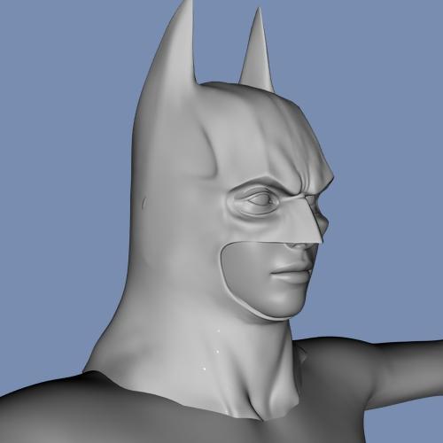

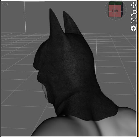

1. Load genesis and mask
2. select mask and pick "fit to" genesis option from parameters tab. Fit to options - figure: unsupported, type of item: none
3. after fitting is done, select mask and unfit it from genesis (fit to: none)
4. select genesis and increase its scale to 103% in parameters tab
5. select genesis head in scene tab and reduce X scale of the head to 97.6% in parameters tab

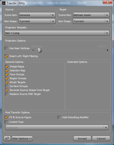

6. Run transfer utility (settings for that are on picture 2)
You should end up with something like picture 1, mask fitted to genesis and than you can reduce genesis size to 100%
If you reduce opacity strength of genesis skinhead surface in surface tab to 0, ear will be invisible. But if you apply smoothing modifier to the mask (which should come handy), smoothing will try to compensate for the ear, making a bump on mask surface. To compensate for that you can increase X scale of the mask to 102.5, 103 %
