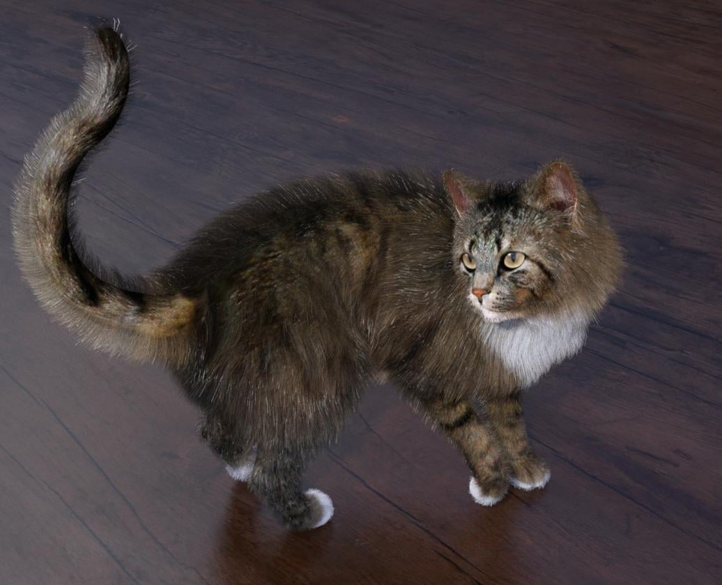

    Iray and LAMH work fine together as long as youn don't get carried away with the amount on the fibermesh.
    The fibermesh in the image is right at 320,000. I found out after I can go as high as 600,000 before the scene freezes
    1036 x 839 - 899K

    The problem is that you really want something in the millions of hairs to look right, which most people can’t manage.
