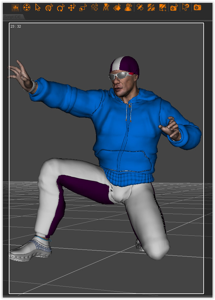

    Hi I create all of my own clothing for the Genesis figures.
    I have  found a less elegeant solution to the "pulled taffy crotch"
    effect that occurs with extreme thighs apart poses.
    In your modeling program push  the upper left /right thigh
    geometry away from each other until they no longer "stick"
    after running the TU.
    Even to the point where  upper/inner thigh,crotch skin  of the figure
    is showing through after conforming and merely hide the visibilty
    of the thighs hip and pelvis in the scene tab.
    685 x 957 - 268K
    Post edited by wolf359 on
