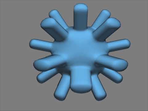

    This was interesting.... if you have Maya.. which I don't crying
  • Hermit CrabHermit Crab Posts: 876
    Stezza, that video shows exactly how people are doing this - thanks for showing it!

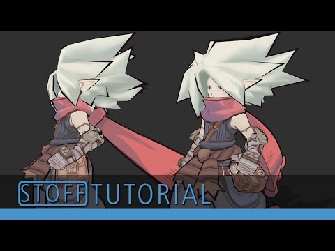

    At the end of watching it, You Tube proposed other videos to see and there were a couple of tutorials for using this technique in Blender.  Here is a link to one of about eight minutes:
    https://www.youtube.com/watch?v=D4T1cDJryOI
    If anyone ever considered uploading some of their toon models to Sketchfab, this might be something to try.  I notice that the 'Staff Pick' awards in the Sketchfab world often go to lowish-poly toon items.
