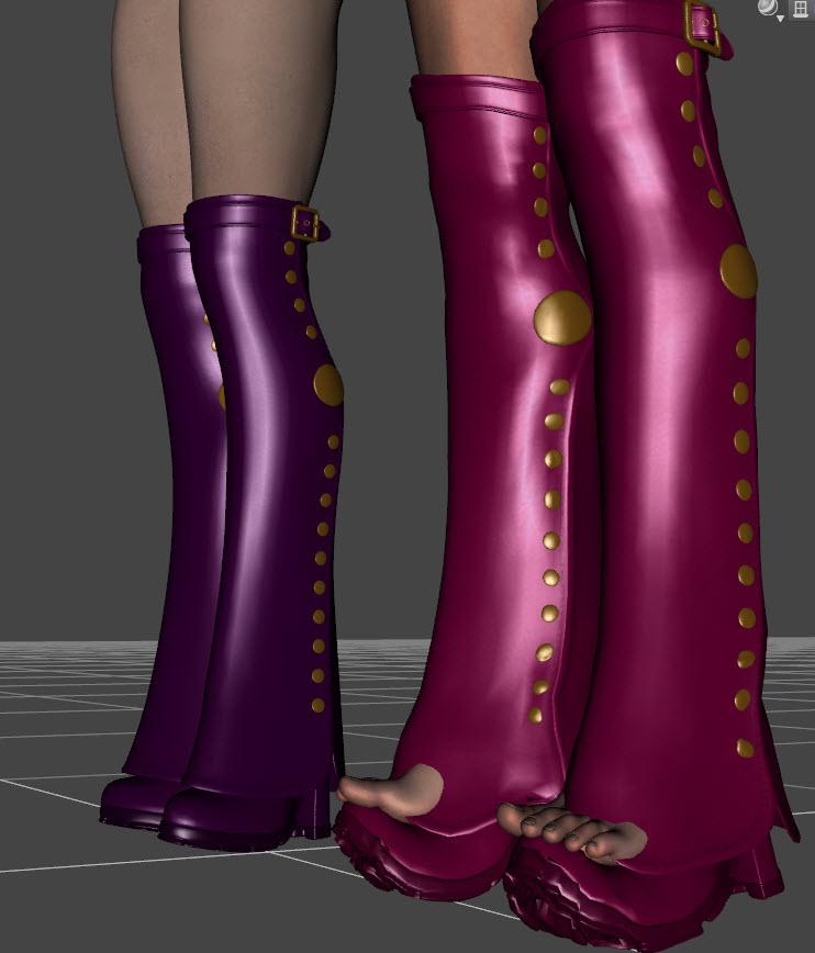

    I have Leopard Shoes for V4 which I have never been able to convert to any Genesis character - the mesh completely warps in addition to the toes poking out above the sole.
    The boots on V4 (left) and on Genesis (right).

    Well a one click solution is probably unfeasible.  However, I'm looking at classes of issues people run into and working out the best solution for each kind of issue. The goal is a sort of pick-your-path reference guide/tutorial.  General rule of thumb - any time you see a v4 shoe with an INJ pose, a foot pose or a HideFeet pose .. it is not going to autoconvert well
    For example the Leopard Shoes appear to be a classic case of shoes modeled to be used with the feet hidden, or perhaps a custom INJ morph.  Since the autoconvert expects the shoe to be shaped like the figures zero pose and shape, it will never convert any shoe well that isnt in exactly that place.  However, a great many v4 shoes are not zeroed, as I'm sure you all have found out.
    The market standard here these days is for the shoe mesh to fit in the zero position and then be posed into the wanted shape - this does make autoconversion work better, but gives the makers more headaches. Many shoes now actually load a pose at the same time as the shoe, but you don't see it happening.
    I just tried the swashbuckler boots and spurs a try going from V4 to Genesis.  The boots themselves went pretty cleanly on the legs - a little crunch on the soles.  The spurs however have a custom bone for the spinny part, and with autoconvert that is lost as well as some deformation.  The boots I would use Hex to smooth out, and the spurs probably need to be manually converted and the custom bone recreated (if I really want the spinny thing).
