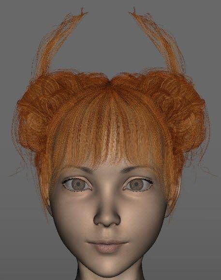

Just tried the BonBon Hair on the Pix Braelyn G8F character, when I apply the hair it first loads a bit above the head, then first the base drops into place, then the buns, but the fringes stay above the hair. The character is rather small, if I dial it to zero so it gets normal G8F height the fringes fit. So they seem to autofit to normal G8F height rather than to the character.
I've tried a few other characters of different height, but no problems with any of these, hair loads directly on head, not above. So it looks like it's either specific for this character, or there's something wrong somewhere in my installation.

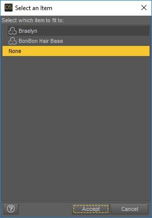

    Thank you. I watched your video but things seem to work differently on my system so I had to experiment a bit to make it work. I'm getting this dialog which you don't seem to get, whenever I try to load the hair with the character deselected. And it seems that no matter what I choose, or if I just cancel the dialog, the hair will autofit to the character. So I have to "unfit" the hair base from the character before parenting it, to make it work.

    Do you get this dialog when you load the hair into the scene with nothing active (that is to say the figure and nothing else in your scene is selected)?   Or does this dialog come up when you attempt to parent the hair to the head of the figure?  If the later, instead of dragging the hair items as shown in the video select the hair you want to parent and right click on it in the Scene editor and you will get a drop down menu with some options.  Be sure to select the Change "BonBon Hair" Parent option and not the Fit option.  Then you will be shown a Change Parent dialog and you can navigate to the figure Head and select it.  Make sure the Parent in place option in the Change Parent dialog is selected and click Accept.  This does the same thing dragging the hair in the video does without the steps but there may be some different setting in your Daz Studio set up that instead of parenting the hair when you drag it to the figure head is prompting the fit option to run instead.  I am not sure on that but if that is the case than this method should allow you to parent the BonBon Hair Base and BonBon Hair Buns to the figure's head without the fit dialog coming up.

    I get the dialog if I try to load the hair without anything selected in the scene. This does not happen in Pixeluna's video, for whatever reason.
    If I select Braelyn first the dialog does not come up when I load the hair, it just autofits to the character as normal.

    Looking at your steps here I see you are fitting the hair to none.  This is what should be happening when you load a clothing or hair to a scene with nothing selected.  Daz Studio would just fit it to none (no item in your scene) but for some reason that does not appear to be the case with your install and it insist it must fit to someting so you have to let it fit and then refit it to none. What you outline appears to work just fine so that will be the better way for anyone having the same problem with the hair wanting to auto fit. as you are having.  The method Pixeluna posted works fine for me so your way is a good alternative to have for those who cannot get that method to work.  Another way that this could be done, since it is the rigid groups in the hair causing this it is possible to go to the geometry editor verties tab and delete the hair rigid groups and then clear generated morphs. But that method is probably better suited to someone who is comfortable using the geometry editor and understands what is involved.
