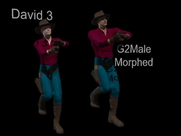

    That probably didn't make sense, but I will attach a pick. I have an old Western clothing set for Daz's David 3. I took each individual clothing item in Studio and converted it to Genesis and saved the result as an individual wearable preset. I then reloaded the result back in Studio, and converted it for use with the G2Male as if it were made for genesis. Within Carrara, I can load the individual items and fit them to any genesis or genesis2 male character that I dial up. That way I can mix and match going forward without saving entire outfits out of Studio.
    In general it works fine, but the inconsistency is puzzling.

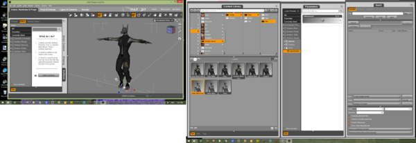

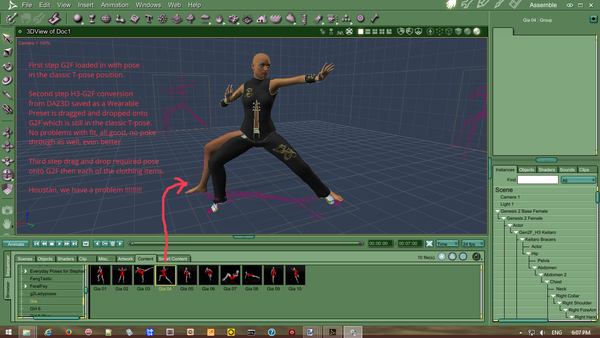

    In the past I have normally been saving the entire character, clothing setup, and pose as a DUF.
    Have been trying the Wearable Preset as it obviously allows for a lot more usage !!!!!

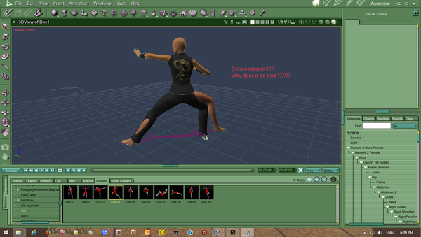

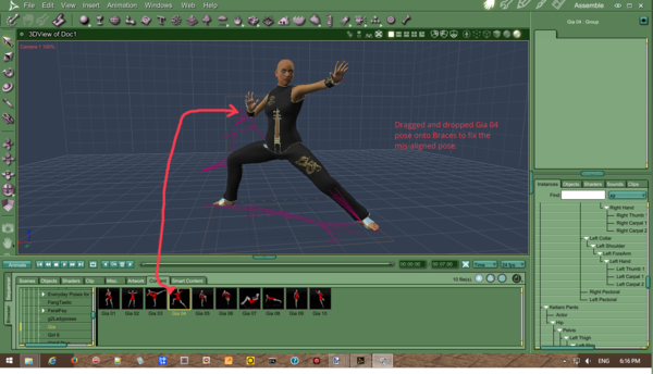

    This has been part of my results (read the comments in RED on the SCREENIES):-
    1363 x 781 - 357K
    1363 x 773 - 387K
    1361 x 768 - 324K
    1358 x 766 - 334K
    1950 x 674 - 526K

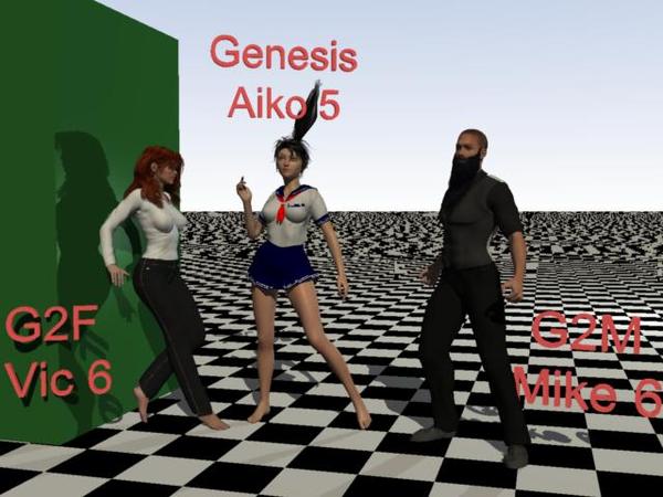

    That was the workflow that I used to make the G2M Western gunslinger shown in a post above. That G2M figure had a mixture of M6 and Freak morphs dialed up. The same pose was applied directly to the David3 figure and to the G2M figure after the clothes were "fit to" in the T pose, not to the clothes.
    In the attached pic, I have used this method for Victoria 6, Aiko 5, and Michael 6. In each case, the clothing and hair was made for an earlier version of the character. V6 is wearing the V4 office outfit by 3DAge at 'rosity and SWAM hair. A5 is wearing the Aiko3 schoolgirl outfit and Aiko3 hair. Michael 6 is wearing the Oskarsson timeless suit for M4 and the M4 beard. The poses were applied to the figures in the Tpose after the clothes had been "fit to."
    I generally dont have the posing problem that you demonstrated, but it is nice to know your trick for applying poses separately when it does come up, which I am sure it will.

  • Bunyip02Bunyip02 Posts: 9,288

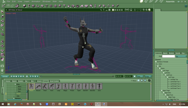

    Hello Diomede
    Will give your method with Kung-Fu Anubis tomorrow.
    Same steps as for G2F, but the Braces will NOT fit this time around.
    For some reason the skeleton rig across the arms/shoulders is lower in the clothes than as for the Anubis character.
    I tried both the H3 DAZ3D autofit conversions for G2F and Anubis and got the same result.
    Was expecting the feet and lower legs to cause the problems. They worked well.
    Regards, Bunyip
    1358 x 781 - 308K

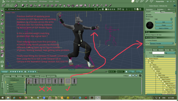

    If at first you don't succeed, try, try, try, and try again.
    Was wondering if the issue with the braces is a weight mapping issue getting confused between the Gen3-Genesis-G2F-G2F_Anubis6 figures.
    I know if I had to do that amount of maths calculations in a few seconds I would be very confused !!!!!
    Tried redoing the braces in DAZ3D from first principles using the Autofit process, changing the clothing types from gloves, to full body etc.
    Nothing worked as I kept getting the same problem.
    Every time the skeleton rig of the Braces across the arms was not matching up with the skeleton rig of the Anubis figure.
    I then tried adding the original H3-Genesis conversion of the braces to the G2F_Anubis 6 figure, followed by using the Animation Group Fit To Genesis 2 Female figure located in the General Tab, and it worked !!!!!
    Hope this helps anyone out who has a similar problem.
    Regards, Bunyip
