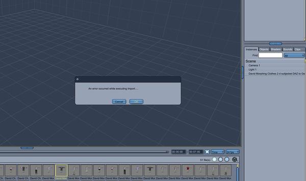

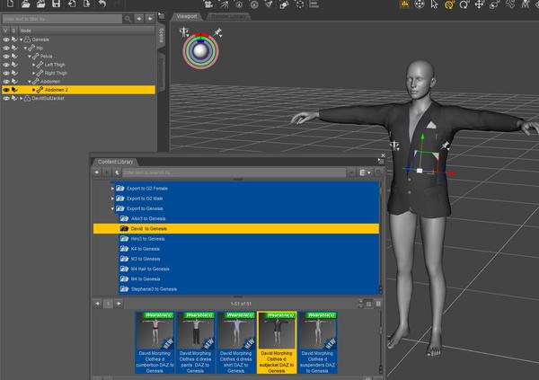

I have been using Daz Studio's "fit to" function to convert a variety of content designed for generation 3 and generation 4 figures to Genesis. I then do a "save as" and choose wearable preset and save to folder within Daz Studio's presets folder. I then save it to Carrara's object browser for future use. It usually works fine.
However, sometimes (rarely) I get an import error, with no explanation. For example, in the attached, I loaded the David 3 suit jacket from Daz's David morphing clothes runtime folder into Daz Studio. I used fit to genesis and saved as wearable preset. As a test, I deleted that item, then reloaded it in Daz Studio from the saved conversion file. Works fine in Studio. However, when I open Carrara and attempt to load the jacket, I get an import error message (see attached). It does not give me clue as to what the problem was.
I have used this method dozens of times with David 3, Aiko 3, V3, V4, M3, and M4 content from Daz and 'rosity with happy success. However, I have this occasional import error, yet the item appears to work just like the successful ones within Studio.
Help?

    Thanks for the suggestion, Dustrider. Unfortunately, the problem cannot be due to Carrara's "fit to" because I am loading the items to an empty scene. And I have tried several "save as" options for the offending items. Can't find a pattern. Hmmm.
    I don't want this to sound like a complaining thread. Using Daz Studio's "fit to" and saving out as a wearable preset has worked seamlessly at least 95% of the time. I have even had success using the genesis clone to "fit to" David3 clothes to Genesis, then used the G2Male "fit to" on the result, but translating as if it were made for Genesis. I have attached an example that worked fine. I can fit most generation 3 items to G2M and G2F even though I only have the respective clones for genesis, not genesis2.
    That probably didn't make sense, but I will attach a pick. I have an old Western clothing set for Daz's David 3. I took each individual clothing item in Studio and converted it to Genesis and saved the result as an individual wearable preset. I then reloaded the result back in Studio, and converted it for use with the G2Male as if it were made for genesis. Within Carrara, I can load the individual items and fit them to any genesis or genesis2 male character that I dial up. That way I can mix and match going forward without saving entire outfits out of Studio.
    In general it works fine, but the inconsistency is puzzling.
