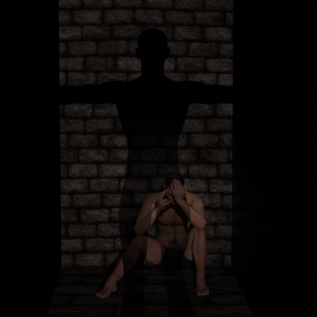

any advice on how to use a figure shadow effect on wall in Iray?
ToobisToobis Posts: 993
edited March 2018 in The Commons
I am trying to do this with godrays: https://www.daz3d.com/epic-props-godrays-volumetric-light-for-iray so preferbly would like advice from someone familiar with this product as I am not having a lot of luck in what I am trying to do in Iray.
I am trying to have scene where a prisoner is in jail and someone opens the prison door and the prisoner looks up at them and the sillouette behind the prisoner is that of the person who has opened the door whom is staring at them. In pic one is the basic scene with the Godray prop behind the guy staring at the prisoner and the second pic is of the sillouette of the guy that is barely there at all much less to a point you could make out what it was or what the person was doing. This should work in theory.
Anyone think of how I could do this or any methods I might have better luck with? Thankyouuuuuuuuu.

    Photoshop. Make a layer over your image and paint over him a shadow shape in black. Change transparency and layer styles until your image is similar. I would suggest the darken layer style

    What kind of light do you have behind the figure casting the shadow? For the best results you should use just a single spot or point light, as this will cast the sharpest shadow. Avoid too much light inside the jail, as this will soften the light of the shadow. Obviously the light behind the figure has to be carefully positioned to get the shadow in the right position.
    Below is the effect I got with one bright spot light behind the figure at the door, and another dimmer one to light the figure in the jail.
