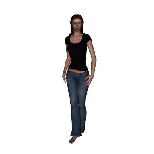

Why does this girl look like she's covered in ashes when using an uberlight upon her (no other light is used, and the default surface settings are used for for the girl and her top)
Post edited by Hera on
It's at minimum quality. Select the uber light in your scene tab and choose the "4x" setting at the bottom of the list you loaded the light from.

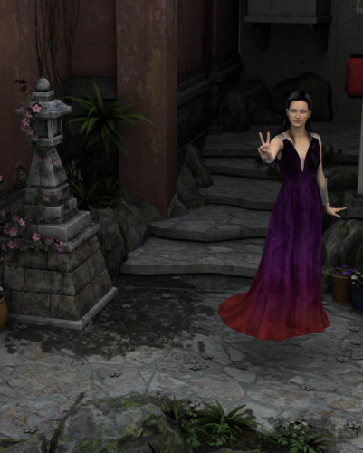

I had the same problem, but luckily I decided to try higher quality. In my humble opinion the highest one is worth waiting. See that "Far East Revisited" nocturnal scene which uses UberEnvironment and "Arlesienne - totally normal" which does not to see the difference.
