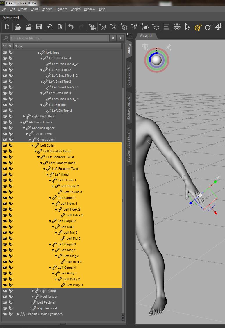

    One I learned on Facebook: you can apply partial poses by selecting the relevant bodypart(s) you want to apply the pose to and doing CTRL-click on the pose you want to apply. Then select 'selected' for both Nodes and Propagation.
