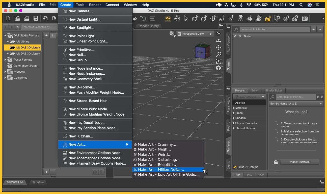

    The one feature I keep always forgetting about is the "Make Art Option"...
    For some reason I always choose the "Crummy" option because I forget the "Million Dollar" setting is much better and makes you a millionaire.
    They need to make a tutorial on how to use this feature... you always hear people talking about the "Make Art Button", but nobody ever mentions where it is.
