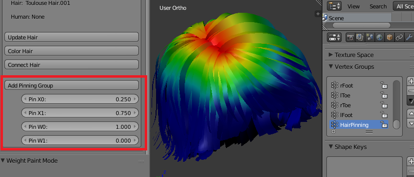

    I mainly use DS as a content generator for Blender. Now in the DAZ importer from Thomas Larsson there's a tool to automatically convert hair to Blender dynamics. I guess what you need for dForce is a similar tool. May be someone with a good knowledge of scripting can write it. The Larsson's project is open source.
    http://diffeomorphic.blogspot.it/
    http://diffeomorphic.blogspot.it/p/hair.html

    In my first test I just applied a gradient falloff and turned off self-collision and it worked quite fine. May be I was lucky with the G8F pack. I didn't try any other hair yet.
    https://www.daz3d.com/forums/discussion/223616/help-i-can-t-get-dforce-to-explode#latest

    Out of curiosity I did a test with the Charm Hair. Always just a gradient falloff so it's a very simple setup. Not bad but not good either. I believe it's because there are too few strands to work with. In the case of long hair this becomes much more visible in the animation.

  • Nice. I admit I never tried anything with the weight mapping until just now. I'm kinda disturbed there's nothing on YouTube about them. I was able to figure out how to apply one similar to your example, and may see about combining both methods. I've got an in-progress file where I'm splitting the Charm hair into multiple sections, and individual strips. I'm up to about 75 new surfaces and waiting for it to crash and burn LOL
    Still the issue persists that was pointed out in the other thread: strip hair is very limited, and downright ugly once it starts flailing about. No headbanger's ball/Deathklok animations, I guess.
