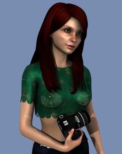

    Okay.
    This render used this light set: http://www.sharecg.com/v/69039/view/21/DAZ-Studio/WC-3Delight-Baseline-Test-Lighting
    The materials settings are as follows:
    Hair UberSurface Shader: Diffuse Strength 15% (used Specular Map), Diffuse Roughness: 2.0. Specular Strength: 40% (used Specular Map for strength), Subsurface Strength: 45% (used displacement map for strength)
    Skin: UberSurface Shader: Diffuse Strength (used colour map for strenth): 50%, Subsurface Strength: 100% (used Lana specmap for strength), Specular Strength: 100% (used Lana Specmap for strength)
    The colour maps are basically VBon2000 Bonnie.
    I know, I know, I broke the rules regarding SSS+Diffuse on the skin, so SUE me... However, on the clothing I absolutely adheared to them. For more shiney parts, like her belt, I have the spec at 90% and the diffuse at 10%. For the jeans, I have Diff: 30%, Spec: 20% and SSS: 50%. Not at all happy with the top... so I'll not bother reporting that...

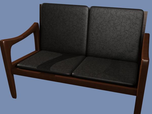

    This couch was posted on ShareCG by FreeFashion: http://www.sharecg.com/v/68822/browse/21/DAZ-Studio/The-70s-couch-with-armchairs
    Same lightset as my render of Sam above: http://www.sharecg.com/v/69039/browse/21/DAZ-Studio/WC-3Delight-Baseline-Test-Lighting
    Okay, applied UberSurface to all three material groups. Applied the Diffuse Texture to the Specular Strength on all three material groups and left the rest where it was. Diffuse: 20% Strength, Specular 80% Strength. Both set to white colour with the colour map only on the diffuse channel.

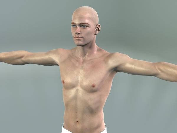

  • evilded777evilded777 Posts: 2,487
    hmmmmmm
    800 x 600 - 202K
  • wancowwancow Posts: 2,708
    Evilded, this won't work unless you tell us the settings :)
    edited May 2013
    but does it warrant it? I have only my own judgment, and that is biased.
    I seek outside verification of the worthiness of my attempt :)
    //only being a little cheeky. seriously, I think its good, but I'm not a good judge of myself.
    Two distant lights, one main and one back/rim. Main light pale yellow, turned down to 70% intensity; ray traced shadows with some blur and lower shadow bias. back light pure white 100% intensity. UE light set to occlusion w/soft shadows, pale blue in color 60% intensity with about 50% indirect light as well.
    David 5 with JM's Gunnar textures. HSS. Diffuse around 70% with the colors maps and pure white diffuse color, diffuse color pure white, diffuse roughness .85 (I went the other way from you, as skin has a broad diffuse reflectance like the primary specular). Both specular channels in use, specular maps applied to both. Specular color pure white (skin reflects WHITE, its not METAL... metal is about the only substance that tints its reflections), first spec about 40% str, 10% glossiness; sec spec 25% str, 15% gloss, 30% sharp. Velvet ON, greenish-blue color, 20% str 15% falloff. Fresnel On, settings off... so I am not going to post them. SSS color maps in SSS color with pure white color; str 30%, ref 1.4, scale 1.
    Large cylinder primitive with a neutral gray diffuse color enclosing the figure.
    Post edited by evilded777 on

    It's very much worth it! I doubt I have that texture set, but I think Philip is pretty close... would love to see if I can get the exact same results.
    edited May 2013
    thanks, you'll find that my specular settings are pretty close to M5 Phillip out of the box, except for the color. Get rid of that blue (?) specular. BUT, each texture set is different. I have a jumping off point that I tweak from there depending on how the textures react to the light I am working with (and sometimes you gotta change the light if it ain't working.)

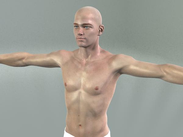

    Slightly refined, with better render quality as well.
    Are his damn nostrils glowing?!
    800 x 600 - 198K

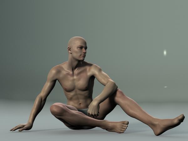

    Last render for now. Fixed his nails, tweaked the eyes but really didn't get what I wanted because of the light angles which I changed... tweaked the lights down. I know he's semi-floating there, but to hell with it.
    wancow said:
    VWrangler, I'm told SSS should be as high as 90 and Diffuse as low as 10 percent... because skin is transparent down many, many layers.
    Here's the problem with trying to be physically accurate: the shader's aren't designed for it. If you read the HSS doc, scant though it is, it notes that SSS is affected by diffuse strength and further it is affected by a diffuse map. How it is affected is not stated.
    You are also going to lose all that glorious detail in the diffuse map if you reduce the diffuse too far, because the SSS channel does not seem to carry it through even if you put the diffuse map there.
    The other problem we have here is that the SSS implementation that we are using is unique. Its NOT the 3Delight implementation, its omnifreaker's version of it. US2 is closer to the actual 3Delight one, but if you really want 3Delight's you're going to have to build your own skin shader and incorporate it. Good luck, I've tried and I still can't make sense of what is happening with it. Not to say you won't have better luck than me!
