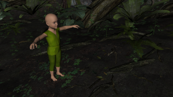

Hi, fairly new to DAZ but not new to 3d, use autocad at work, but got a problem with some clothing items. There is what I assume are anchor points or guides of some sort, little purple wedges, that appear with the fairy clothing for kids4. Is there a way of turning these off as they are showing up in the renders. I've attached a pic that shows what I'm rambling about. Any help will be hugely appreciated.
    Sometimes called 'handles' ... look in the Scene Tab. They should be appearing as a bone with the clothing item they are for. Close the 'eye' to hide them. They are used to apply some additional posing abilities to the clothing items.
  • fixmypcmikefixmypcmike Posts: 19,738
    If that's on K4, look for a utility pose to Hide Handles, or turn off visibility on the Handles in the Scene tab. If it's been Autofit to Genesis those methods probably won't work, so go to the Surfaces tab and find the material named Handles and set Opacity Strength to 0

    Thanks for the help guys, you got me looking in the right direction. Was nothing under the scene tab or utilities but found a setting for them in the surfaces tab. I was able to adjust the opacity down to zero. So problem solved. Thanks again.

    Handles are basically attached to extra bones on the figure to move things like skirts and other flowing parts of a garment. The handle itself isn't really intended to be visible, so doesn't come with morphs. Manipulating them directly can give movement to the outfit they're attached to, hence their name.
    They're fairly common on older figures including many V4 items as well as the lovely Sadie Fae outfit for toon girl Sadie.
  • Richard HaseltineRichard Haseltine Posts: 111,904
    One problem, that Mike refers to, is that when an item is AutoFit to Genesis the handles are treated as part of the mesh for the clothing and can no longer be selected and hidden (or set not to render) on their own. That's why their surface has to be set to zero opacity, though that's normally a second-best over hiding.
